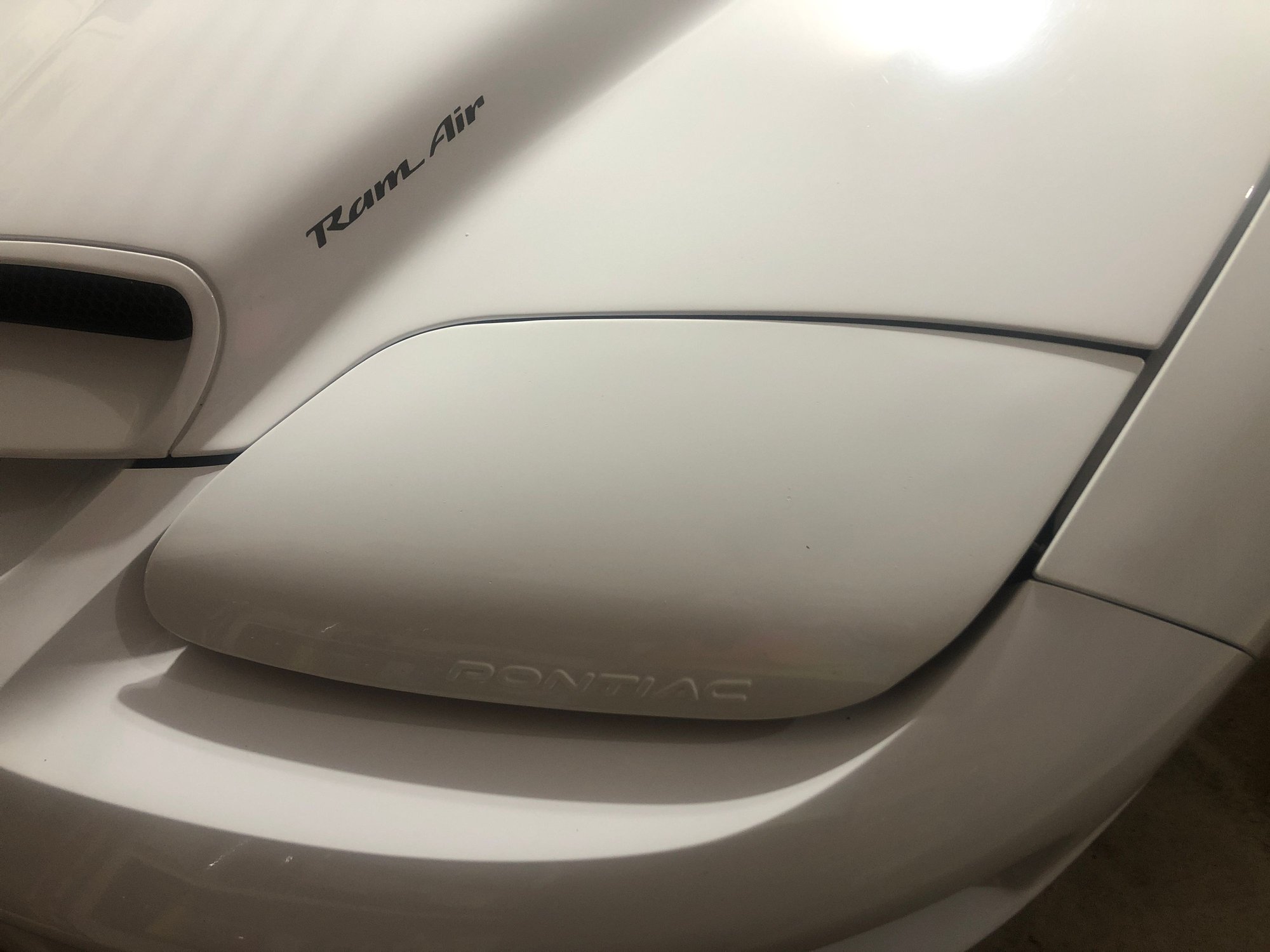

I noticed this morning that my headlight doesn’t line up with my hood. Its almost angles down in the corner. It used to be completely level with the hood is there a way to fix this. thank you

Yes, open the hood and you'll see the slots with screws on the upper backside of the headlight covers, and you can adjust them there.

Interesting topic and helpful photo. I have not had an issue yet over the many years but a simple fix is always good to hear about.

I should add that the plastic front cover has to come off to access the front metal cover screws, if that is needed for the alignment.
