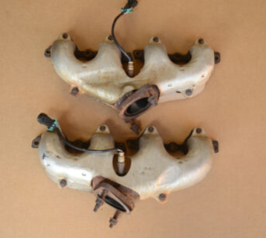

Are you not sure your going to swap? because the whole LS family uses the same mounts in the jeep.
I used NOVAK, (YJ) took about 2 hours to cut the old ones off with a cuttoff wheel and mig weld the new ones on.
Their directions were spot on.
Note: C5/LS2/LS3 exhaust manifolds are sweet on a Jeep, the truck manifolds are too wide on the driver side,
Headers were not gonna be worth it for me.
Thanks for the info. Yes, I already received the Novak engine mounts but have not cut the old mounts out yet. I also ordered Novak's headers but its been two months and they still cannot give me an ETA on when they will have some in stock. I am open to suggestions on another brand of headers to use that will work with the Novak mounts on a Jeep TJ.
