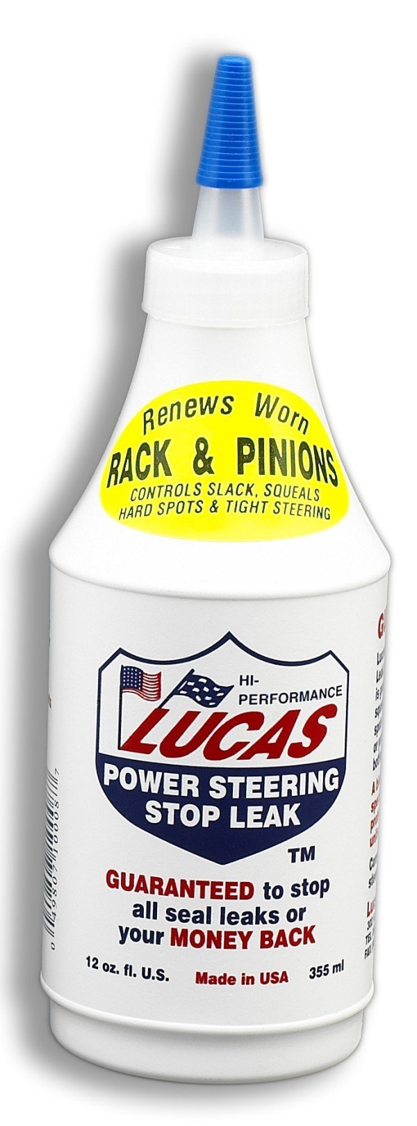

For what it's worth, my Trans Am power steering whined and the fluid was empty when I bought it. So I figured there was a leak...
Filled the reservoir with Lucas Power Steering Fluid and it stopped the whine and hasn't leaked since (I assumed it had a leak).
