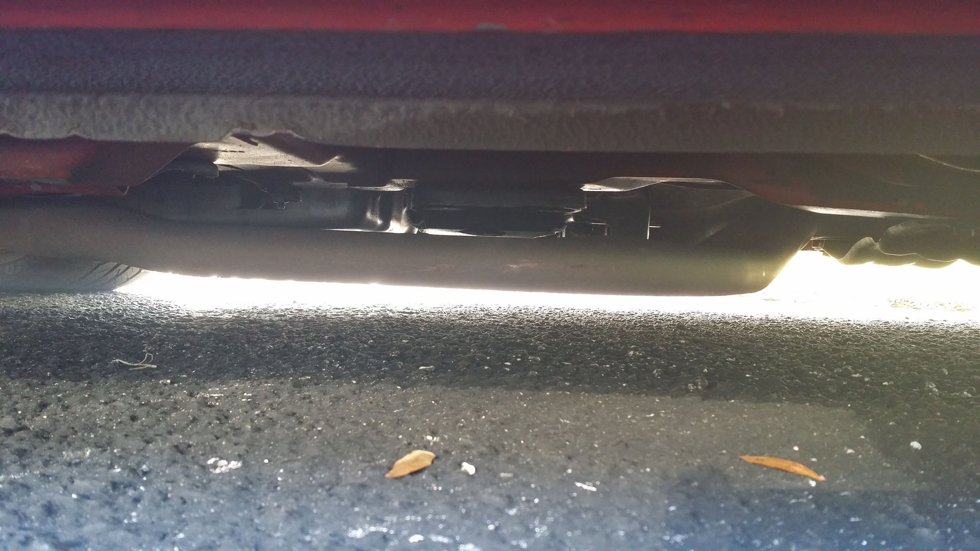

My car has been lowered but is my stock Y pipe supposed to hang tht low?

man that y-pipe does look a bit too low for being stock

Shouldn't it hug the frame more?

Thats what I thought ....I thought maybe I might have put it on the wrong side but the pipe doesnt line up when the flat side is on the pass side so I know its not that......and everything that is elongated its pushed up as far as itll go. The car has been lowered but I dont remember the pipe hanging that low after it was lowered
Although its not vibrating anymore i dont know what else would have caused it
