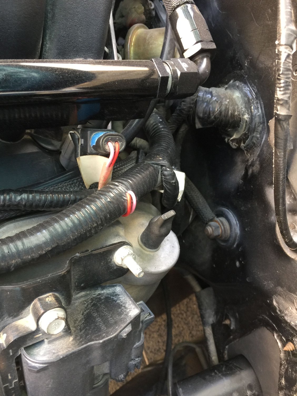

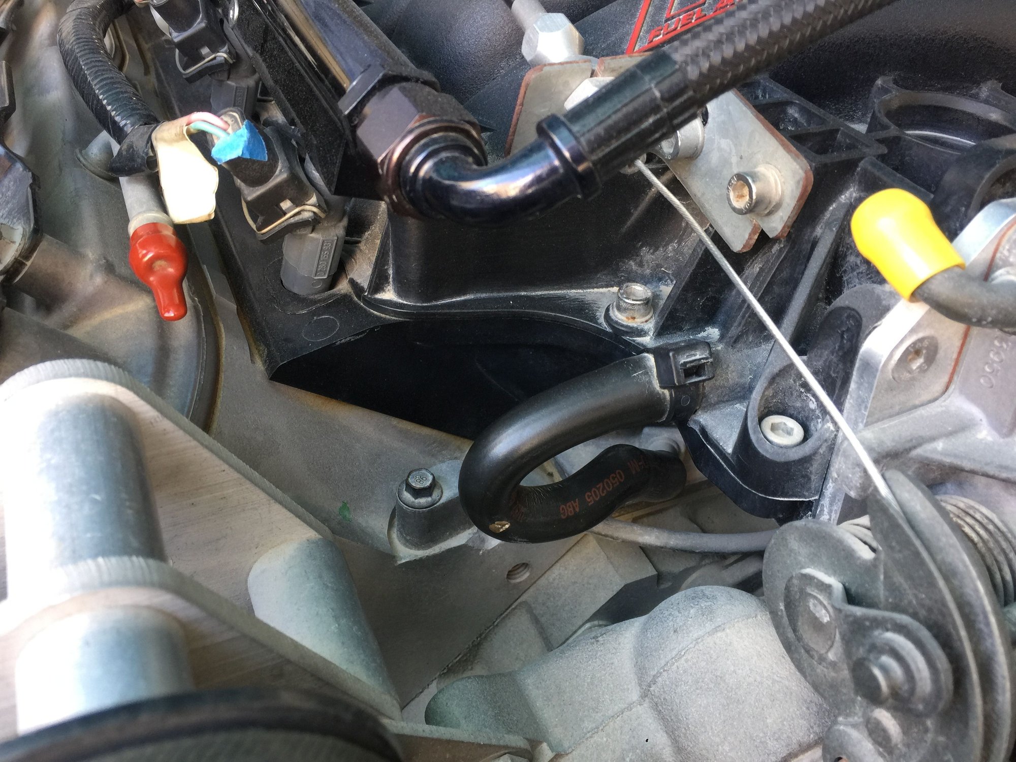

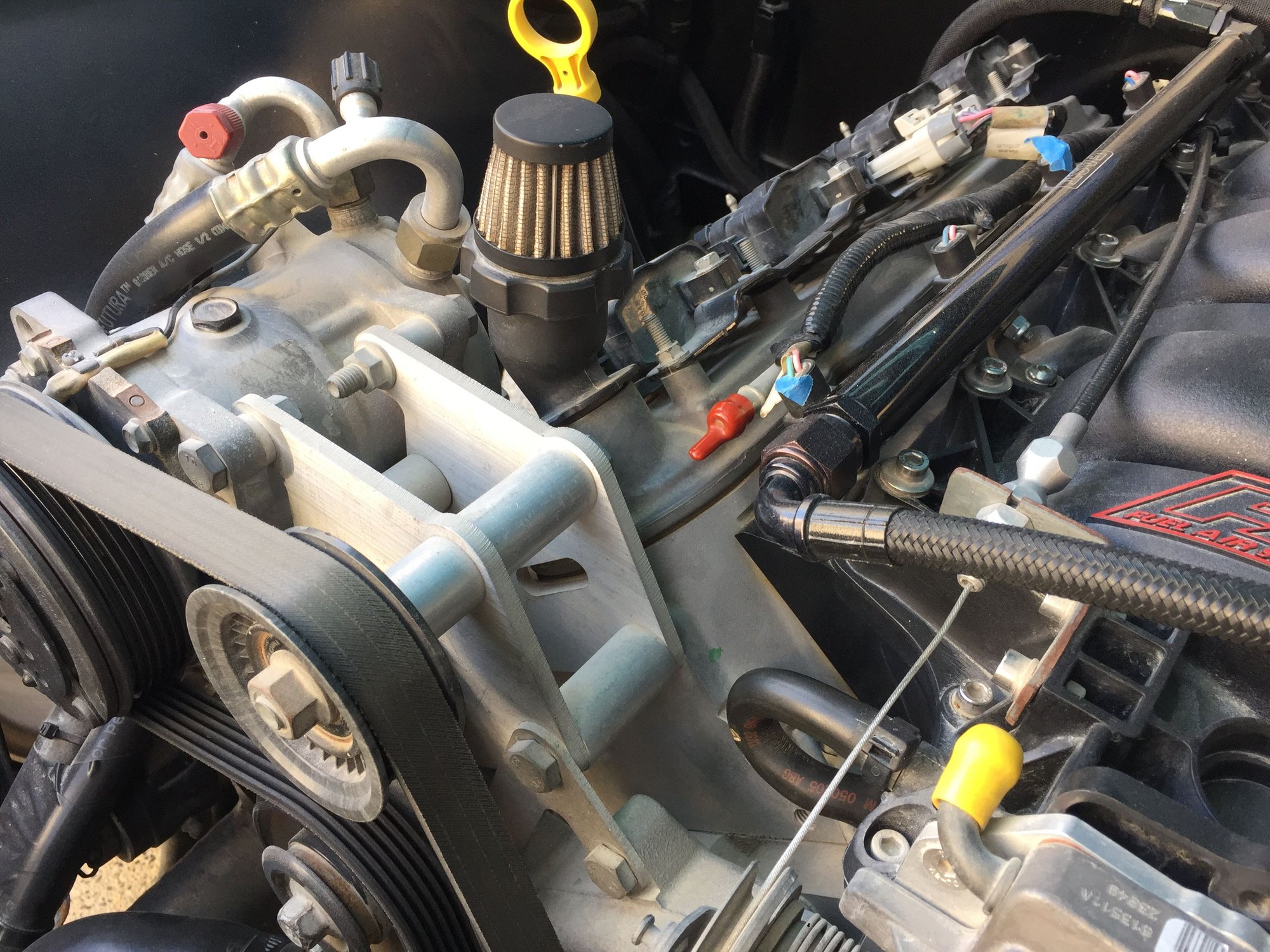

I have just come across this thread about LS6 PCV system. I have a 68 camaro with LS6 engine installed by previous owner and not quite sure whether or not the valley cover has got the built in PCV. The previous owner did the following mods as seen in the photos. Cross over hose from valley cover to intake, capped off the driver side valve cover, also removed the hose from throttle body to passenger side valve cover nipple and capped both ports off(red&yellow caps). Also, put a breather on oil cap.
I did the test mentioned here to check whether I have a built in PCV or not. Removed the oil cap, blew through the tube connected to valley cover nipple. What I observed is that it was not extremely difficult to blow into it nor was it like blowing through the tube it self. Felt also air coming out the valve cover opening for the oil cap
Old Feb 12, 2021 | 07:57 AM
MIGHTYMOUSE's Avatar
iTrader: (59)
Posts: 10,018
Likes: 51
From: Virginia
it is probably fine based on the u-turn hose looking oem, however using the oil cap breather vs. connecting the passenger cover to the top of the throttle body is called 'unmetered' pcv and can throw the tune if not planned for.
your driver cover will have the built in control, you could switch to that vs. the valley if there is concern or for comparison
