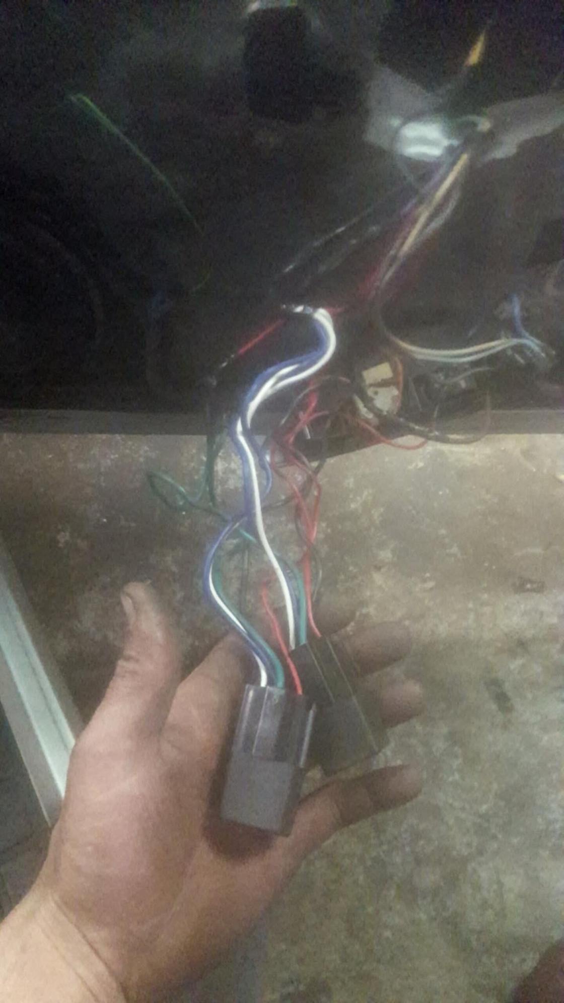

1999 Trans am. Found these relays in my passenger door. They hook up to the passenger window switch and ground to chassis in front with big black wire. A large red wire connects to fuse block in engine bay. They do not seem to connect to anything else? They do not look OEM. Any idea what these are for? Can they be removed? Im so lost here.
Pics attached.

Power window relay mod would be my guess. Speeds up the passenger side window. Did mine years ago but can't recall exactly how I wired it. This explains it good.
http://www.camarozone.com/forum/f20/...dow-fix-23707/
