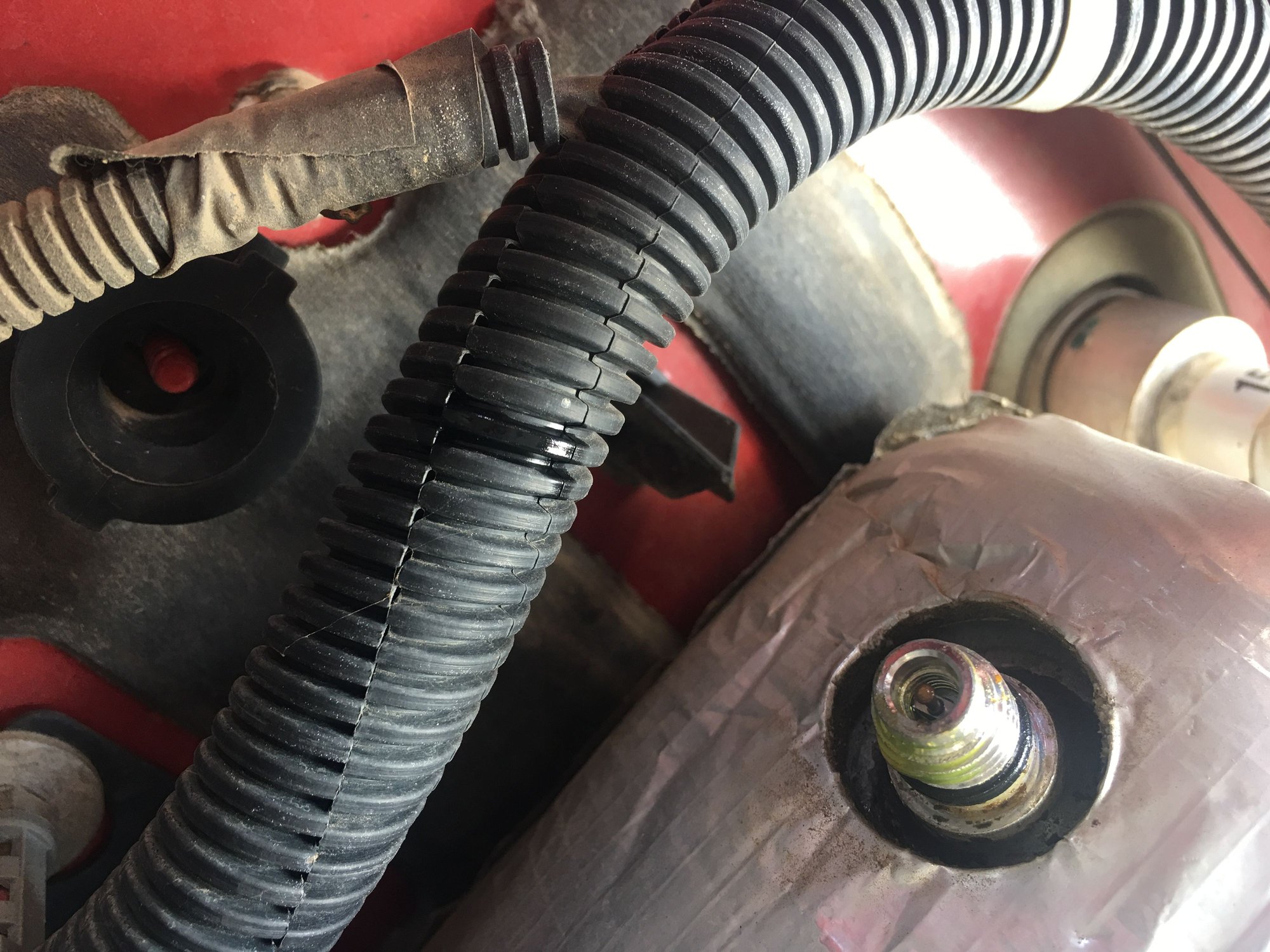

This isn't on an Fbody but on an 02 Tahoe. A few weeks ago, the AC stopped blowing cold at idle, but would blow cold as hell when driving. Everything appears to be fine except for the low pressure switch, no big deal I ordered a new one.

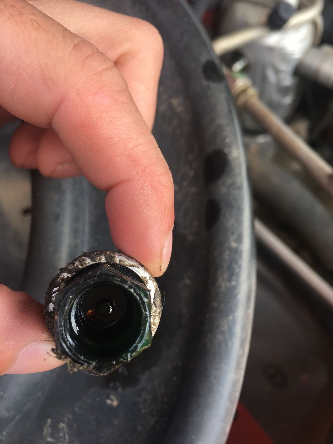

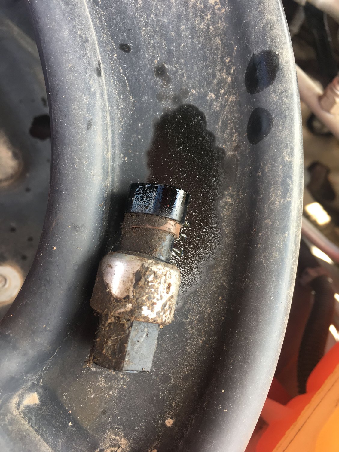

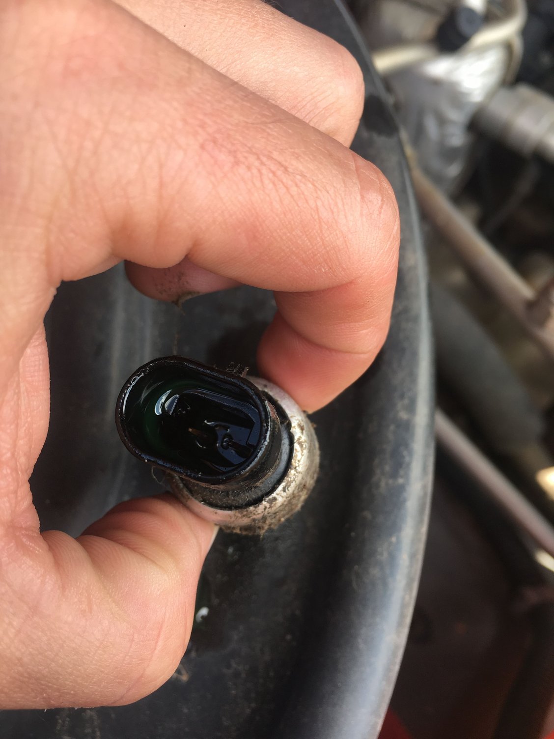

Looking at the switch, the connector and switch are nasty, covered in oil. I pulled the switch out and there is a green oil all over both ends of the switch.
Is it safe to assume that just the schrader valve let it leak into the switch?

Looks like the switch failed internally and let Freon and dye escape through it.
