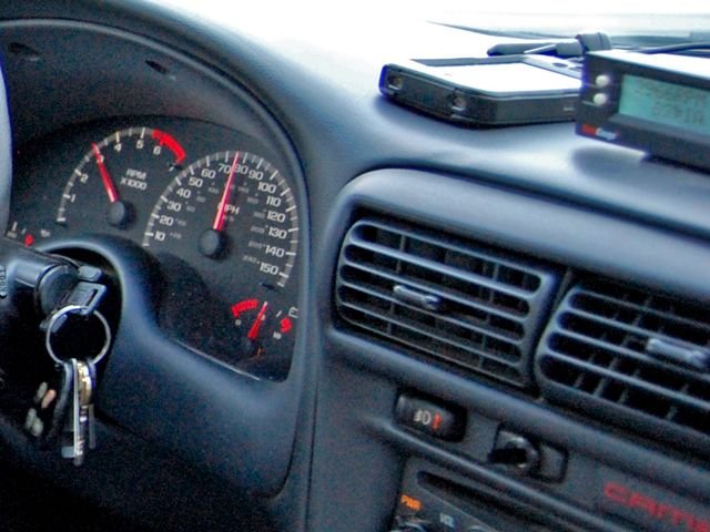

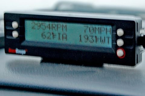

I use a ScanGaugeII(OBDII port) to get accurate readings of parameters. It's mounted on top of dash center. It can read many functions of which some are: closed/open loop,intake air temp,coolant temp,engine load,mpg,rpm,tps,volts. For accurate mph I use a GPS.Due to the inaccuracies of the factory gauges,it's typically on intake air temp,coolant temp,mpg,and rpm.
