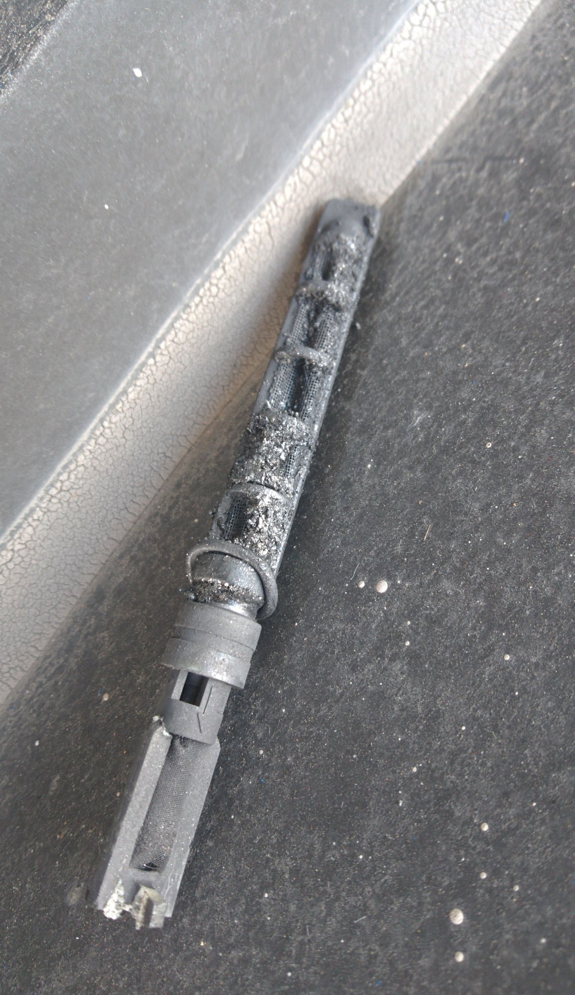

Your advice was followed. I however had to flush lines at home. A lot of stuff came out, orifice is completely blocked. See photos. Unfortunately I have another issue. Since the orifice tube was so contaminated I decided to try to flush evaporator. I only had a cup of solvent left, It went in the evaporator (through the top opening, connecting to accumulator) but nothing came out.
I tried blowing air through. This is fairly painful for me, i use the flush can to store air than go to the car blow and go refill and repeat. I did this 3 times and nothing came out. All solvent is in the evaporator. What do i do to get the evaporator clean? I hope taking out my evaporator+heater core is not my only option
