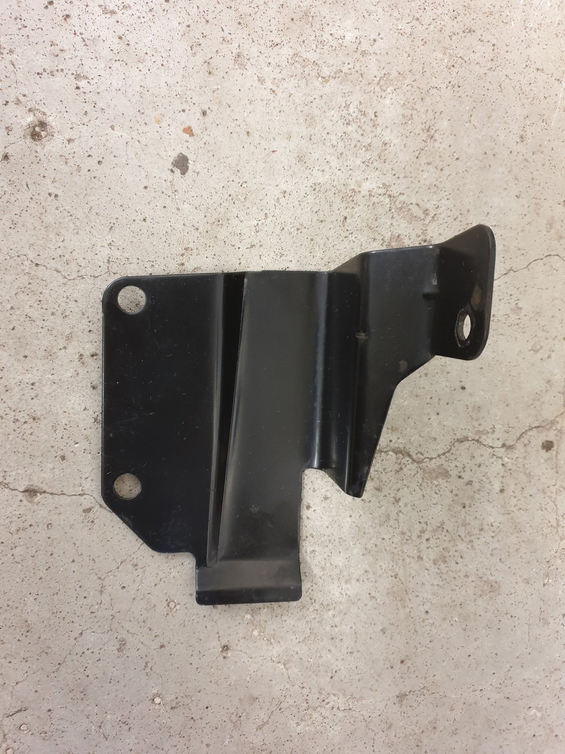

Started to restore my Camaro 1997 in 2011 and have now forgotten there to put this part. Anyone?
It is a bracket that protects the cruise control module
Goes on drivers side in the front wheel well
2 sheet metal screws hold the top while 1 bolt from the sway bar bracket goes in the bottom....the sway bar bolt with a stud on it and a m6 nut

I believe it is for the hood release cable protection, OR crash sensor and airbag sensor protection (haven't looked at it in a while). On my 2001 the throttle cable does not go anywhere near that part.

It protects something.....

Cruise control sheild. GM #12550734
