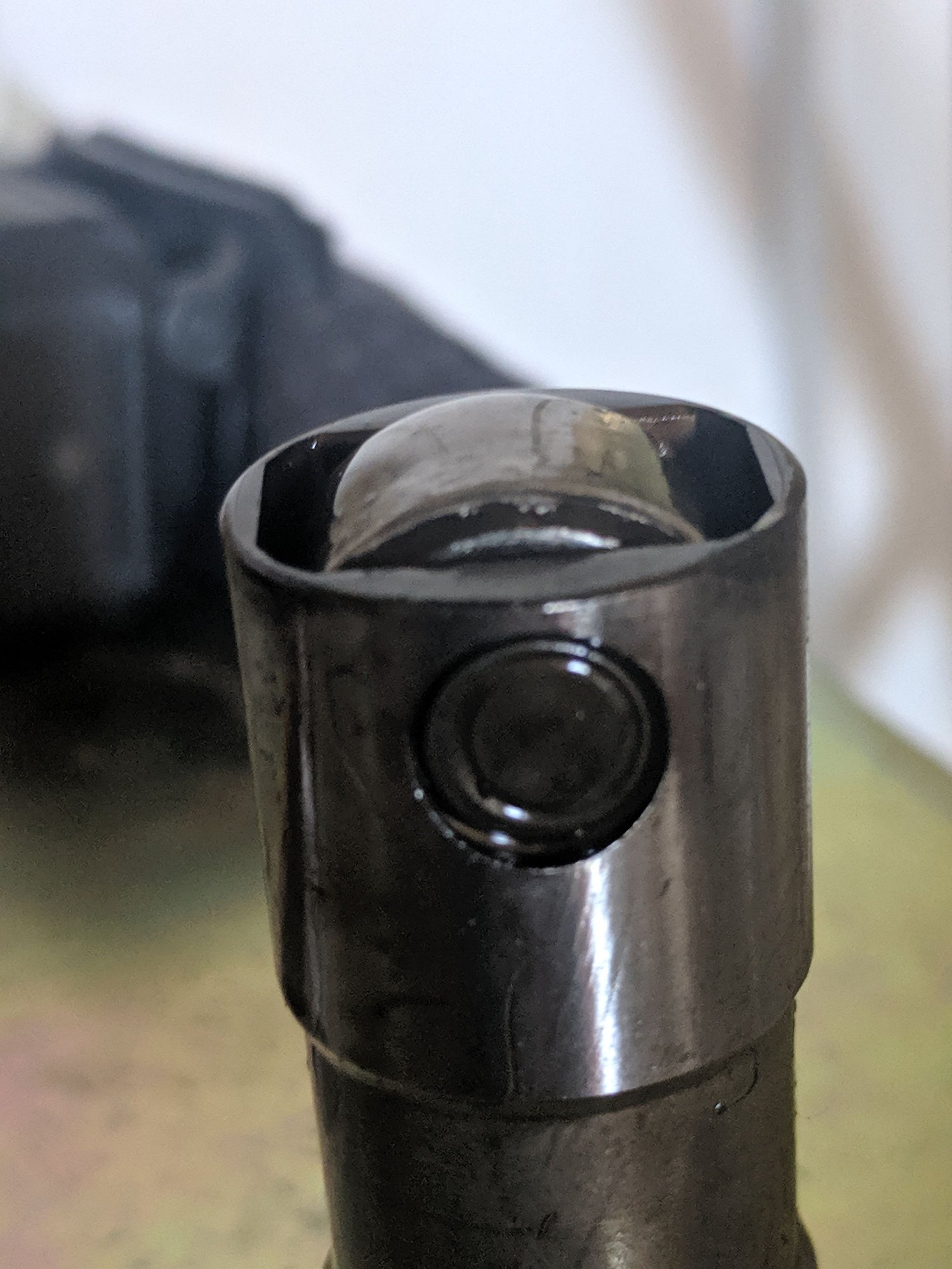

Looks like a lifter issue. Worn down on one side and a tiny amount of metal shavings.

You'll need to inspect the lobe on that cam to see if its hurt. If its bad go back in with new lifters and replace the springs and valve stem seals in the heads or have them gone through by a reputable shop.

What valve springs? What engine? What lifters (Stock?)
A strong spring on a stock lifter will do that, also dirt/debris/sand just one grain can do that also. Usually happens during a cam swap.
