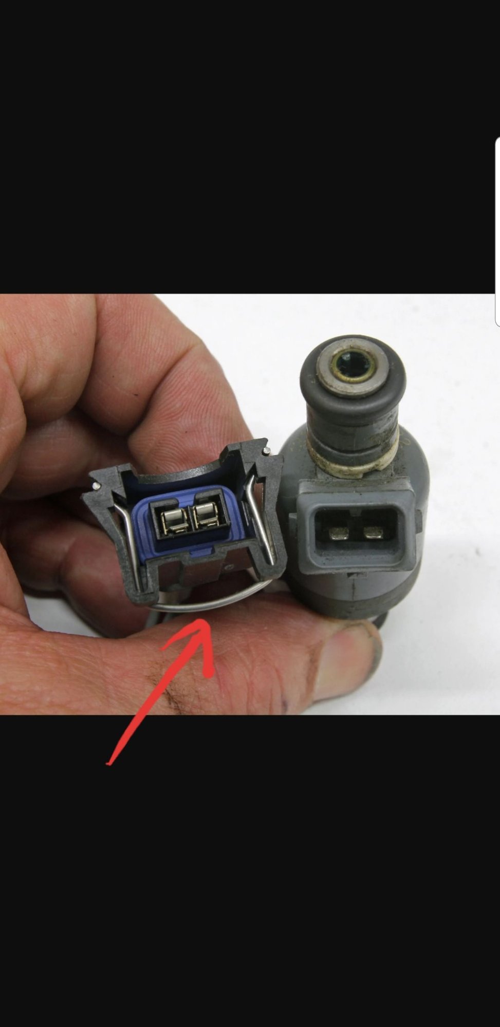

Hey guys,
Can anyone tell me what the part number is on this retainer clip on injector harness please....I seem to have lost one off of my harness. I was thinking of just making one from a paper clip.

If you go to Aptiv's web site, (formerly Delphi, the supplier of most of GM's connectors) you can find detailed info on all the connectors: https://ecat.aptiv.com/feature?search=12129140
From that page, you can get to the detailed schematics to confirm that the connector is an exact match: https://ecat.aptiv.com/docs/default-...rsn=c3e9cf49_4
^ That schematic also has the part number for the clip: 12077996 ... but, I don't think you'll be able to find it for sale anywhere.
You are probably best off to just get a new connector: https://www.mouser.com/ProductDetail...xCde6%2F7jg%3D
^ If you search for "GM Delphi / Packard - Bosch EV1 Type Injector Connector", you may be able to find a pigtail with the connector on it, via eBay for less. The part and clip may not be the same quality as the OE version you'd get from Mouser, (Mouser also ships in 24 hours and will send priority mail.) but that may not be important to you and ordering from Mouser will come with a minimum of $6 or $7 for the shipping.

does that assembly include the blue gasket ? cant see it anywhere in the description
lost one once......ended up getting one from painless wiring ( joys of them bein local ! )

Yes, the connector should come with everything in the drawing: connector body, retainer clip, and seal
