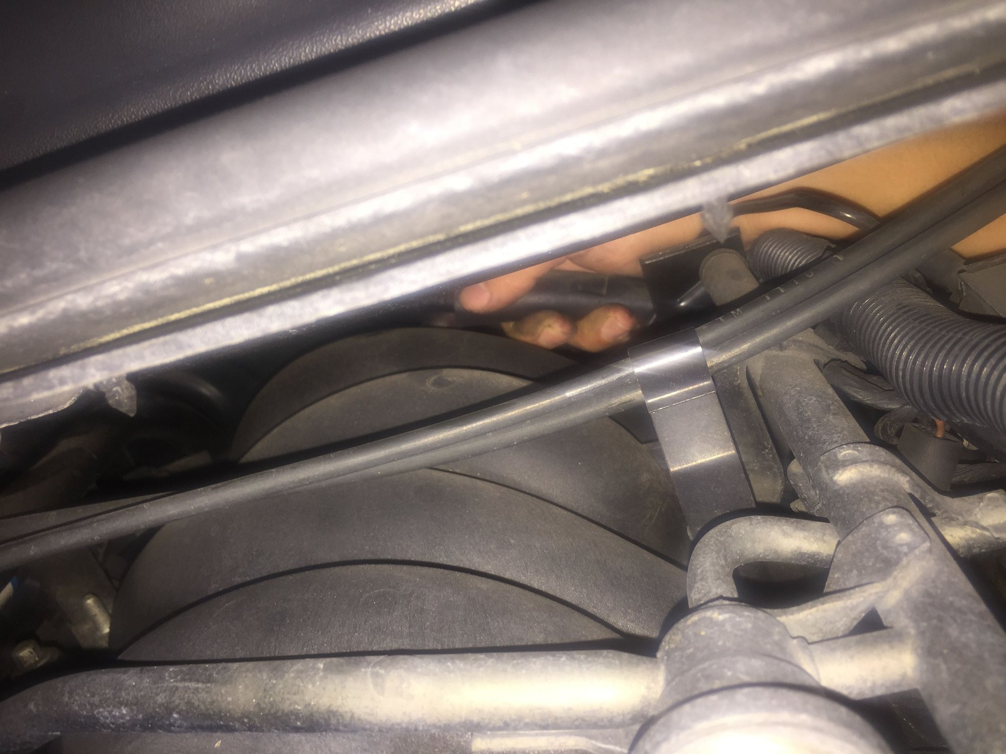

Looks like the pcv system hose is broken in the back. I didn't even notice it until i started looking for oil leaks since i have oil leaking which I think is the rear main seal. I have a catch can system, but i think this whole hose system has to be replaced. Has anyone had experience replacing it? I know there is a ls6 valley cover system that can be installed but that require grinding?

From my experience the hose in the rear has a rubber grommet that falls apart with age. In the past I have simply used a vacuum Y or T fitting with new hoses and haven't had any issues.
Edit: Also check the rubber grommet that holds the PCV valve if you are still using it. That thing crumbles and falls apart as well.

Yea you can buy 3/8th ID hose and a plastic or metal T. When you remove it all you'll see that it's a lot more simple than it looks. I'd buy some clamps to put on the T because sometimes feeding it back under there can require force. You can cut the stock tubing and get the pcv valve hard line off and slide it into the new 3/8 hose. Pretty easy.

2001 called to ask if ya got the memo ! ....yes you can cobble the hoses together to make it work or spend $$$$$ for a new hose.....but in the long run the LS6 VC is the better option
