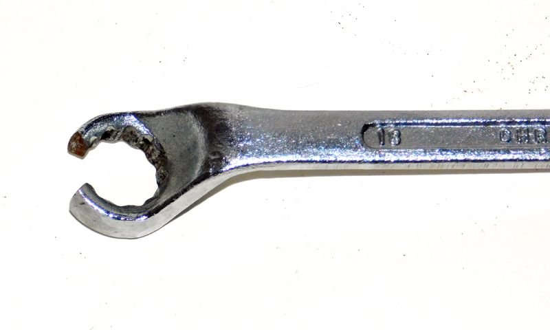

For the rack I had to modify a 18mm heavy box end wrench into a tube nut wrench. My 98 was 18mm, don't know what size a 99 would be.
