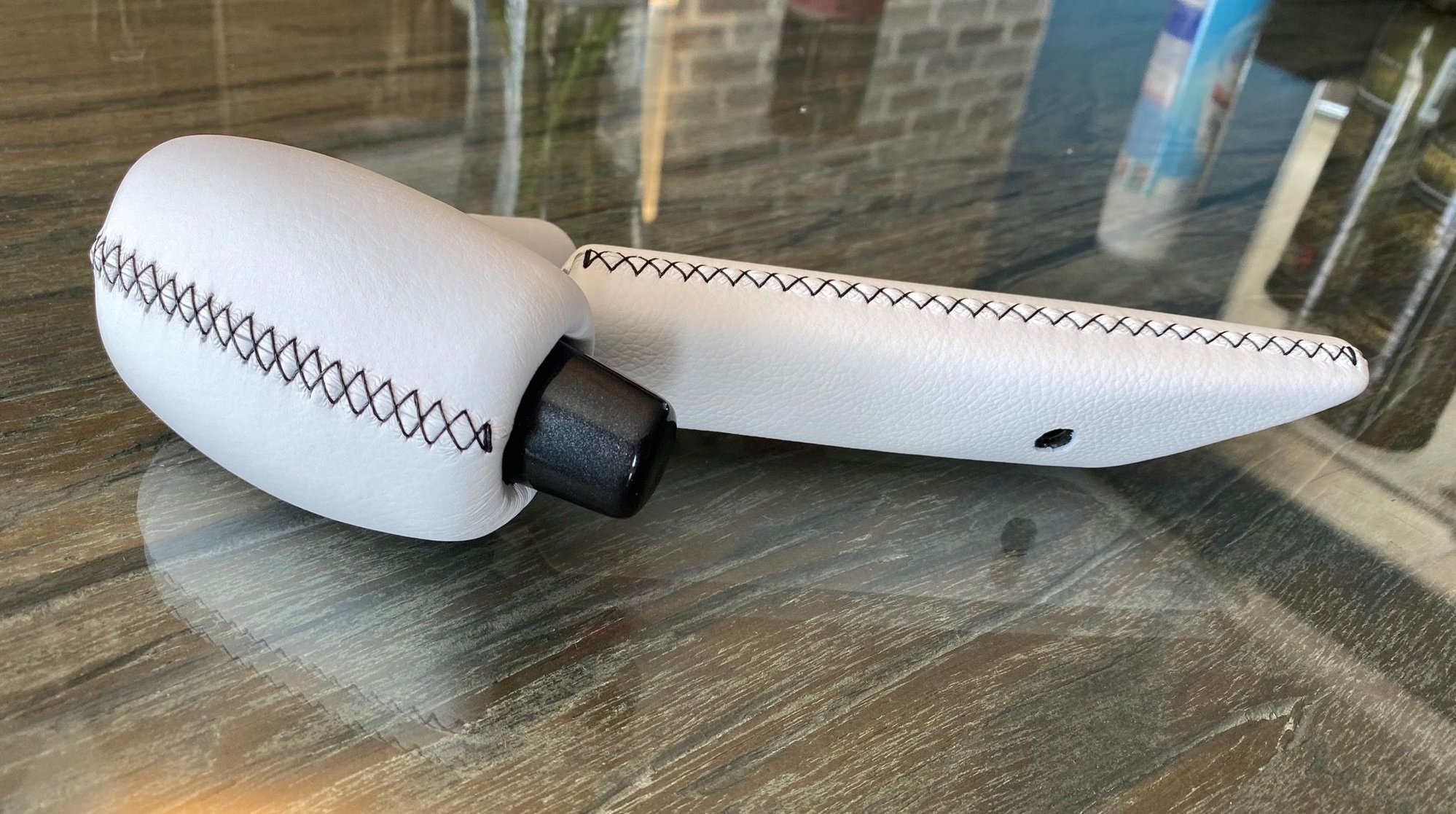

I have had mine off a few times - I actually replaced it with one I bought on eBay and had to custom leather wrapped - they are out there and I have my original - pic of my new ones
