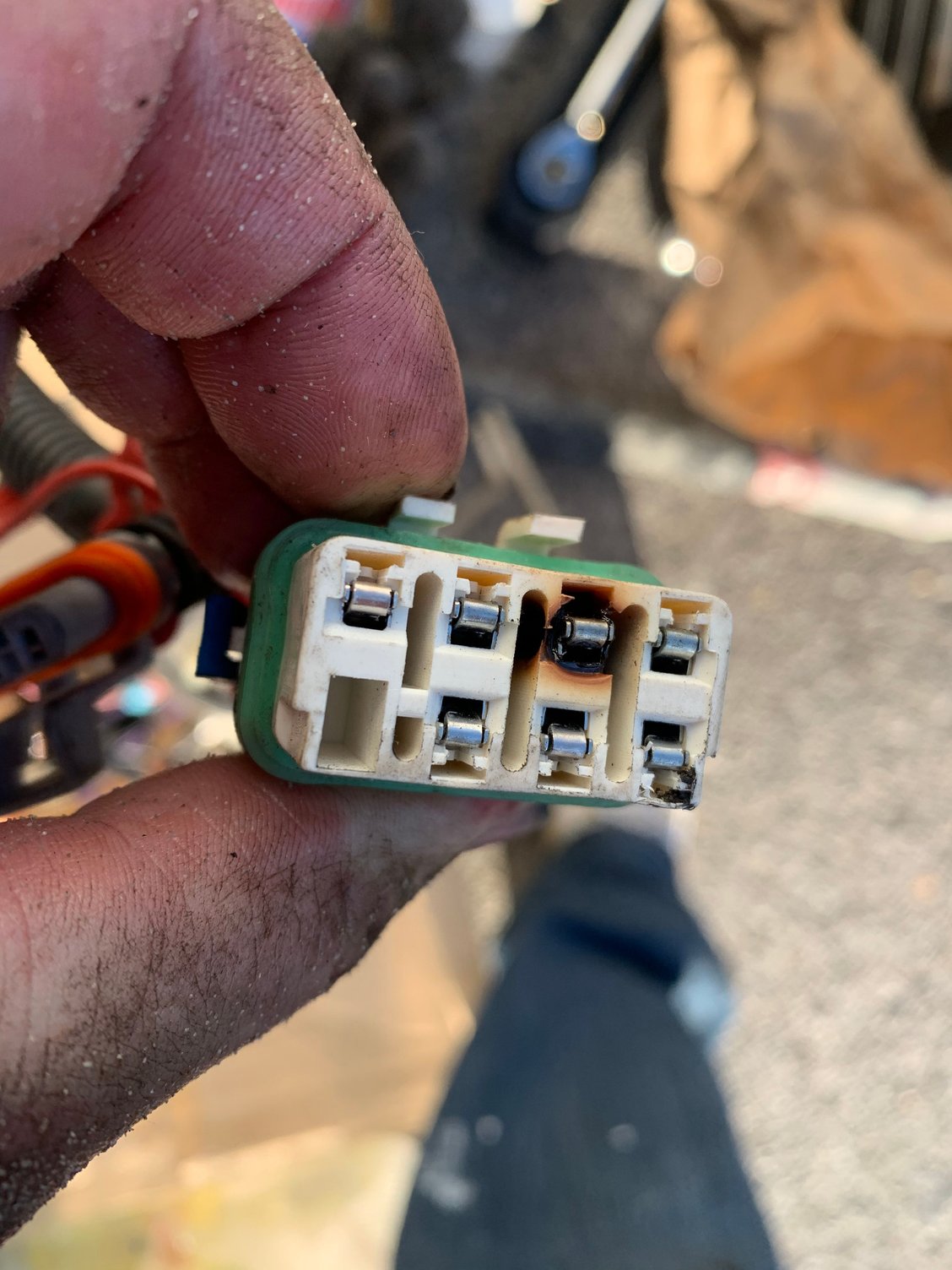

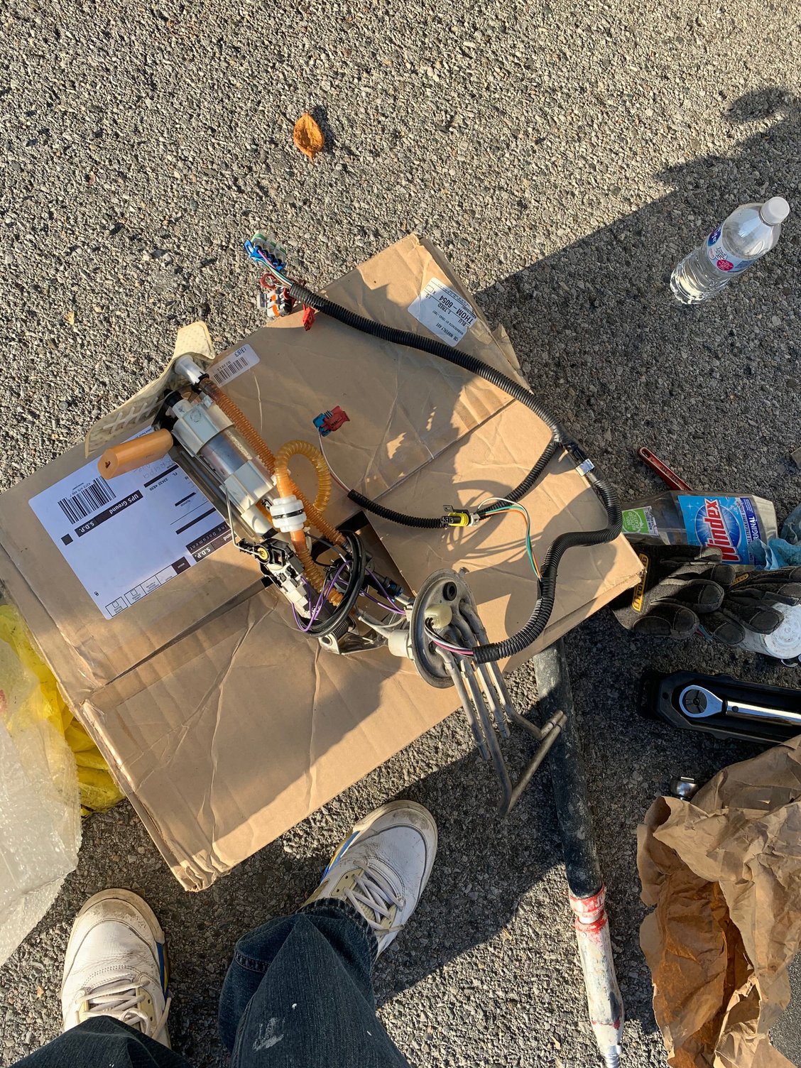

Old Nov 9, 2020 | 05:50 AM
peterock98's Avatar
iTrader: (25)
Joined: Dec 2002
Posts: 1,093
From: NY
After replacing the alternator and my O2’,the problem was my fuel pump .I went to buy an pump from Chevrolet dealer and they said 1998’sare discontinued. I found a Delphi fuel pump on Summit racing part number HP 10038 .Anybody hear good things about Delphi pumps ?
