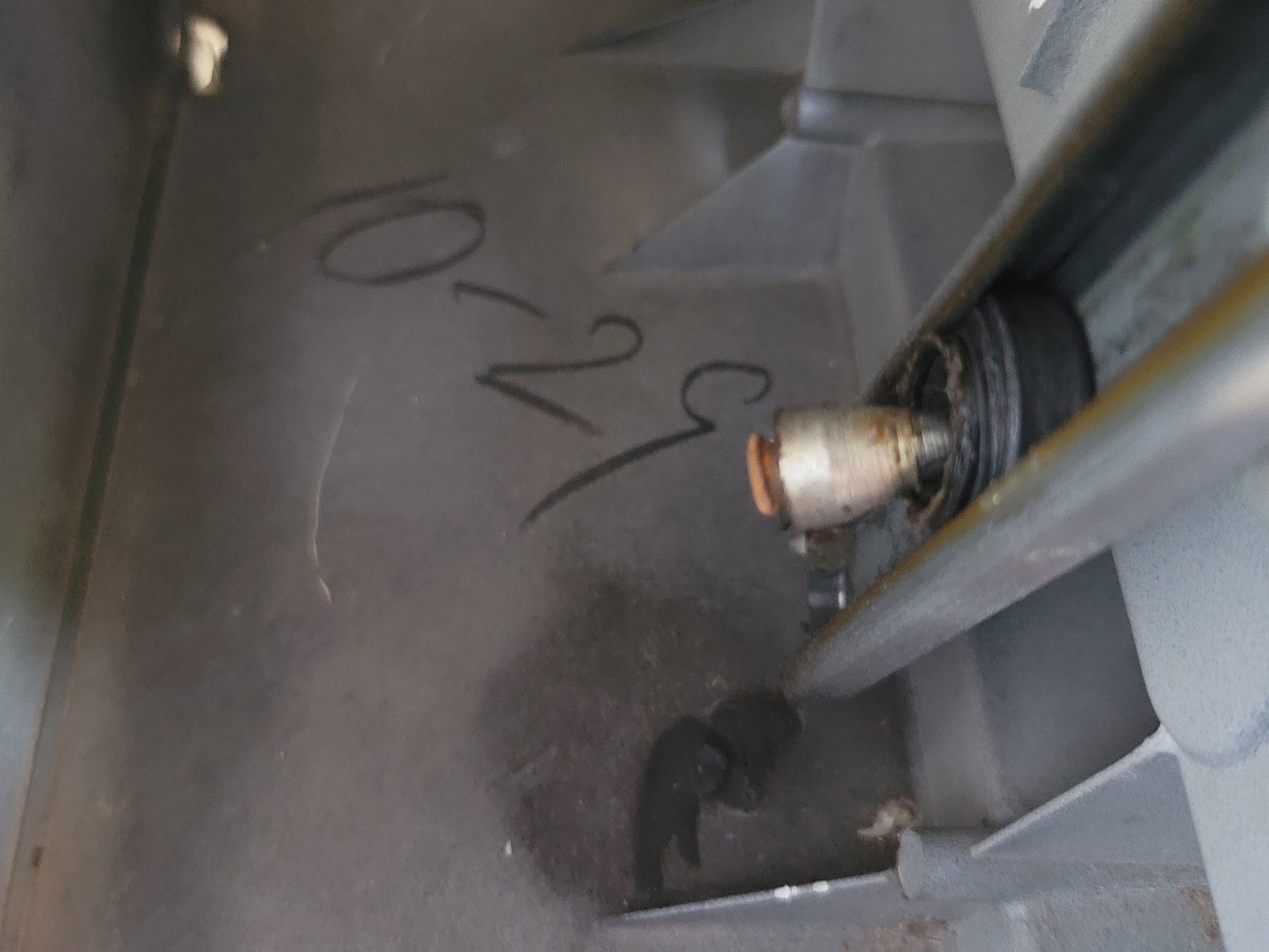

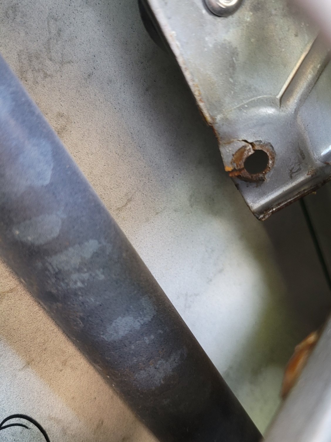

Welp I opened the door back up and found my issue.
is there a fix for this besides welding it back on?

No other option. I would also have some additional metal or a washer put in there to back up the old metal. (No matter if you weld it or a shop does it.)
This is a common problem and we have a few threads on it. There are no proper replacement rollers and the proper part (a new frame for the window glass with the roller installed) does not seem to be available. (So the only source for a replacement part is the junkyard.)
Some people have rigged other solutions to this with bolts and foreign rollers. IMO - welding the original roller back in is the best repair.

I ended up threading a tapping the old roller. I added 2 waters to the back where the bolt went in for extra surface area and proper spacing. Window seals perfect.
also added a picture of parts used.
