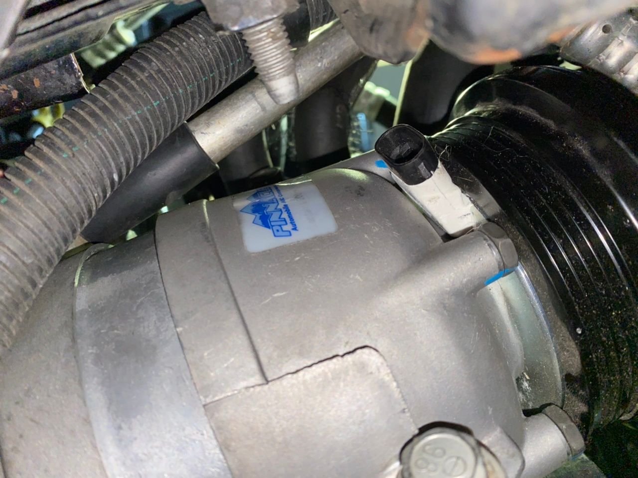

After a decade an half, I decided to put my AC system back in. Back in my early 20’s I was looking for any hp I could find- and cheap. Oh how priorities change over the years. Now all I want is to be comfortable
So I ordered a whole new system, it’s all back in. But for the life of me I can’t find the two prong plug that connects the AC compressor*. I’m not sure what 20 year old me did with it, I highly doubt I would of cut it. Maybe I hid it in the wire loom somewhere. Anyway, worst case scenario I’ll have to run a whole new one from the ECU. Anyone know what two wires I’d need to tap into?
This is the only free wire I found but it doesn’t reach and the prongs don’t match. The car use to be a automatic

Wire colors are DK GRN and BLK.

Condenser? I think he means COMPRESSOR. No wires go to the condenser, which is in front of the radiator

Whoops, you're correct. I meant the compressor.

Right on, much appreciated!
