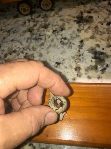

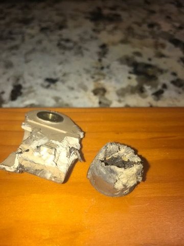

Now it's out !!
I got the propane torch out and got it really hot---smokin'. It got brittle and cracked (after I tapped it with a screwdriver) and I got a pick thru the hole I drilled, clamped it with vice grips and tapped the grips with a hammer until it came out. I have never spent this much time and trouble fixing ONE single problem. I could have pulled the whole front end, all accessories, crank pulley and cam cover and reinstalled before I got this done.
Plug part broke off first. The round part is the part that was stuck in the cover,
Had to use a diamond drill to get thru the magnet.
