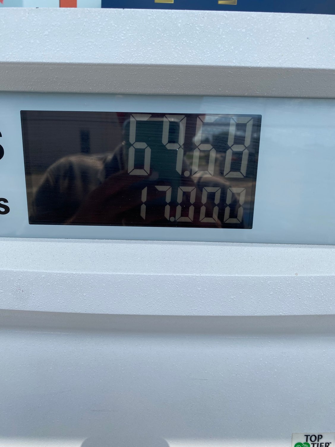

Here it is again at a completely different gas station... I didn't have much gas to spare, my needle was between quarter and half gauge, which for my car means maybe a gallon left...
I thought the needle moving all over when low on gas was normal for all cars... I wouldn't exactly call this a "modern" car... some of the tech or parts were never changed from the 70s... a 5th gen f-body would be much more "modern"...
All of my 4th gens (both 15.5 gallon steel and 16.8 gallon plastic tanks) have had several gallons left even when the gauge showed no more than 1/4 tank.

One thing I'll add to this discussion about fuel tank capacity, a 15.5 gallon tank capacity doesn't mean plum full coming out the filler neck/hole totals 15.5 gallons, it means 15.5 gallons is the safe full level in the tank, where the gas station pump would shut off automatically....the tank capacity is designed with extra capacity for expansion and proper return line/vapor/venting operations. Although it is tempting to "top-off" the tank full to the brim, it is actually not a good practice. Doing so, will not let your fuel return system work properly, put more strain on your fuel pump, ruin your vapor canister and evap system components. If a person is able to get 17+ gallons in a 15.5 gallon tank, they're definitely "manually topping-off" the gas! You'll get away with it, until you don't, when your vapor canister is full of gas for starters!!!

Lots of good information in this thread. @MMBM has the technical answer to your question. The filler neck holds over a gallon in itself. The measurement of the "tank" is just what the volume of the tank holds without the filler.
I would regularly fill up over 16 gallons. Sometimes 17 and 18 gallons, but usually on long highway runs and road trips where I would run into the "red" on the gauge where I knew my mileage and where I was consistently burning gas. (I could get nearly 30 mpg driving at 55 mph, so if I slowed down, I knew that I could go another 80-90 miles safetly when the check gaguges light came on.)
So, all of this should not be a worry in itself. However, if you are filling up at this level across multiple pumps/stations and your gauge is not in the red - then you probably have a problem.
If your gauge isn't in the red and you do not get the check gauges light, (and you are filling over 16 gallons) then you probably have an issue with your fuel level sensor.
If your gauge isn't in the red but you DO get the check gauges light, (and you are filling over 16 gallons) then the needle on your gauge cluster could be off.
