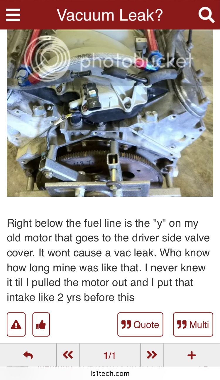

This fella says he never noticed that his was disconnected.. Post #7
If those three lines are not connected you most certainly WILL have a vacuum leak.
I certainly thought so.
