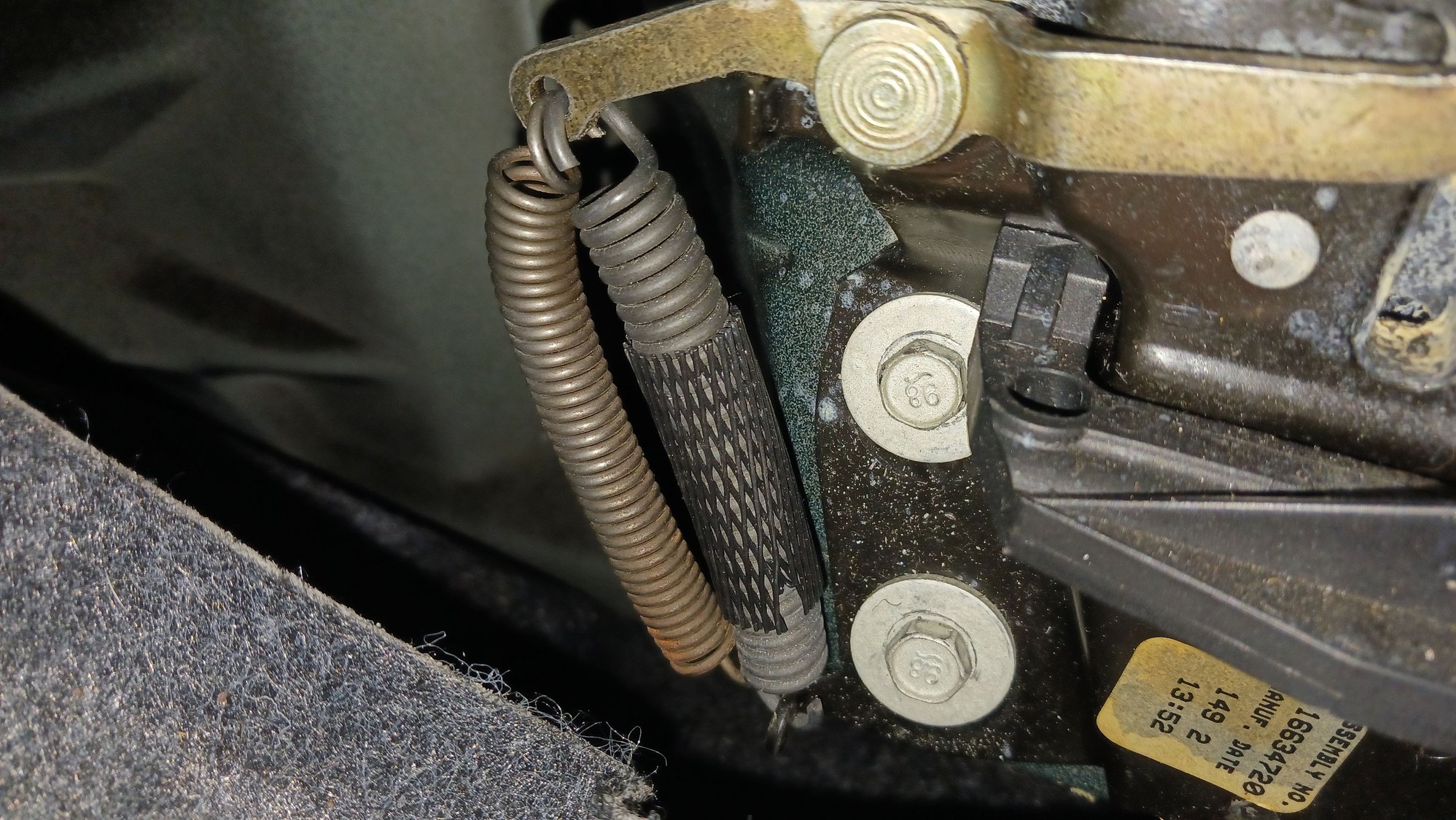

Here's mine. Been at least 15 years since I looked at it.
Next problem is it takes too much slam to close it.

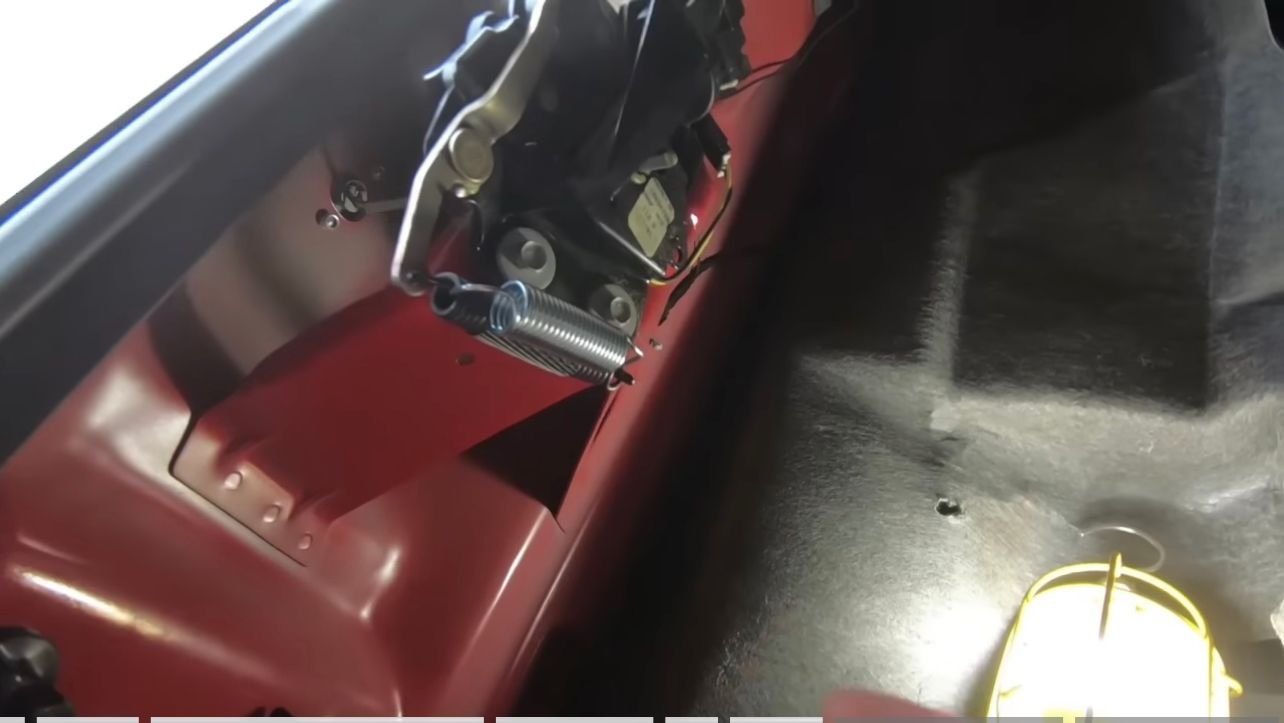

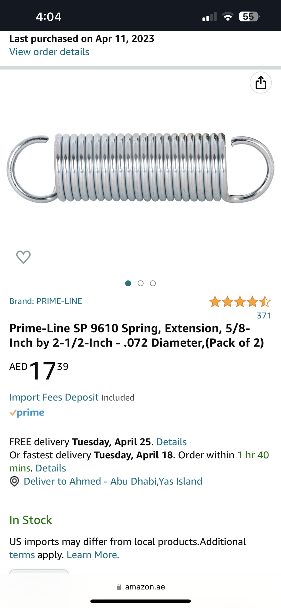

Update: I just saw a video on YouTube, I ordered the exact same spring he used. Hopefully this will fix my problem. Any idea on what to use to clean the area (trunk latch) before I install the extra spring ?
I just washed my car today and noticed that the trunk latch needs some detailing.
from my understanding, all I need to do is just attach or mount the extra spring on the oem spring. Please see the attached pic for reference. He inserted the extra spring inside on the bottom and on top.
do I need to add some grease to the hatch tab or the trunk shocks after adding the spring or is it an overkill?
