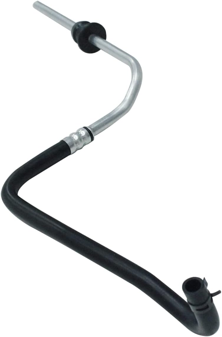

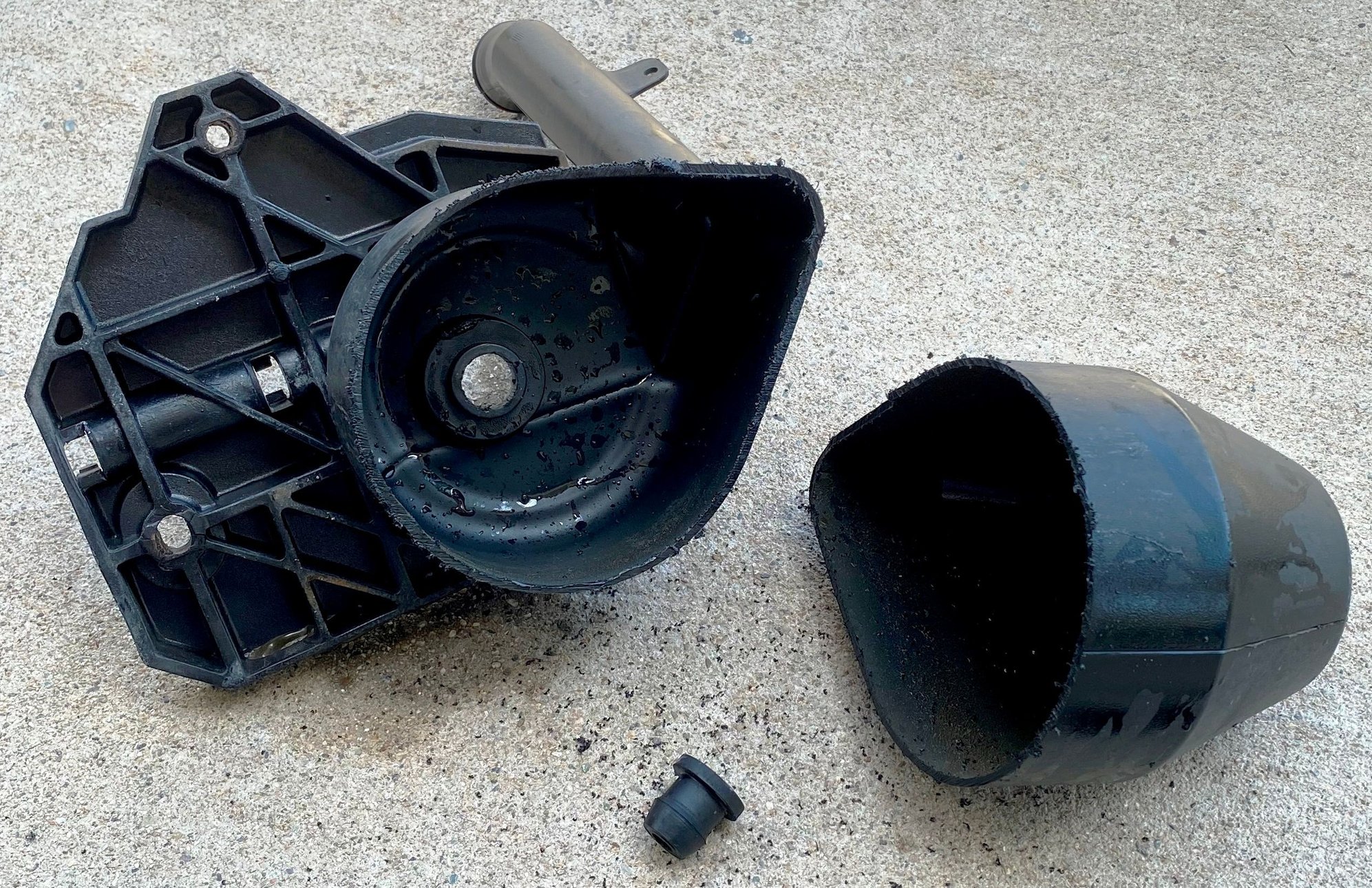

I used the Dorman and reused the grommet/hose/tube assembly. The Dorman looks like the original. As mentioned above, the grommet is hard to get out, so I pulled the hose/tube assembly out of the old tank and hack sawed the bottom off of the tank so I could push the grommet up and out.
Dorman 603-116 Front Engine Coolant Reservoir for Select Chevrolet / Pontiac Models $47.78 Dorman 603-116
https://www.google.com/search?client...Dorman+603-116
Coolant Reservoir 10402687
https://www.ebay.com/sch/i.html?_fro...2687&_osacat=0
Pontiac Firebird Engine Coolant Recovery Tank Hose - Coolant Overflow Tank Battery Tray Hose Grommet Replacement For 93-02 Chevy Camaro Firebird
https://www.google.com/search?q=Pont...t=gws-wiz-serp

Great minds think alike. I also sawed off the bottom half of the tank to remove the grommet. Bob
