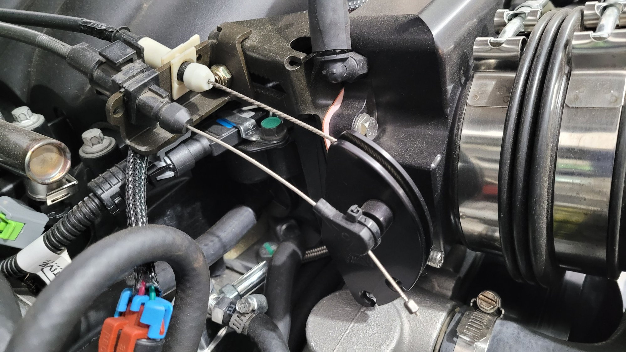

Here's what it looks like when I pull the slack out of the cable, there's about 1 inch.

Here's my temporary but in all honesty will become permanent solution. This is a bicycle brake cable adjuster. This combined with the cable adjustment feature I finally found in the cruise control cable has all the slack out.
