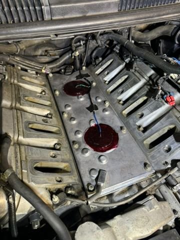

I just put everything back together. I bench tested both knock sensors on a vice for both resistance and voltage increases when tapping with a hammer. I installed both knock sensors hand tight and then torqued to 15ft/lbs, then tested both knock sensors for resistance and voltage again. I then connected the plugs, RTVed the edges, and tested the ends of the harness for resistance and voltage again. Taped down the wire and ran it in a way that it definitely isn't pinched, and I even have access to the connector itself after the manifold is installed. If it doesn't work now, then the Fbody spirits hate me. I installed an LS6 valley cover while I was doing all this, so I have that improvement at least. I did snap the brittle little plastic evap hose that goes into the driver side of the intake manifold, so I need to replace that before I test drive it tomorrow.

^ Seems like you have covered all the bases quite well. I expect it to work nicely this time, fingers crossed!
Is that EVAP elbow still available? I thought I remembered it being discontinued, at least by GM. Maybe someone else is making it now.

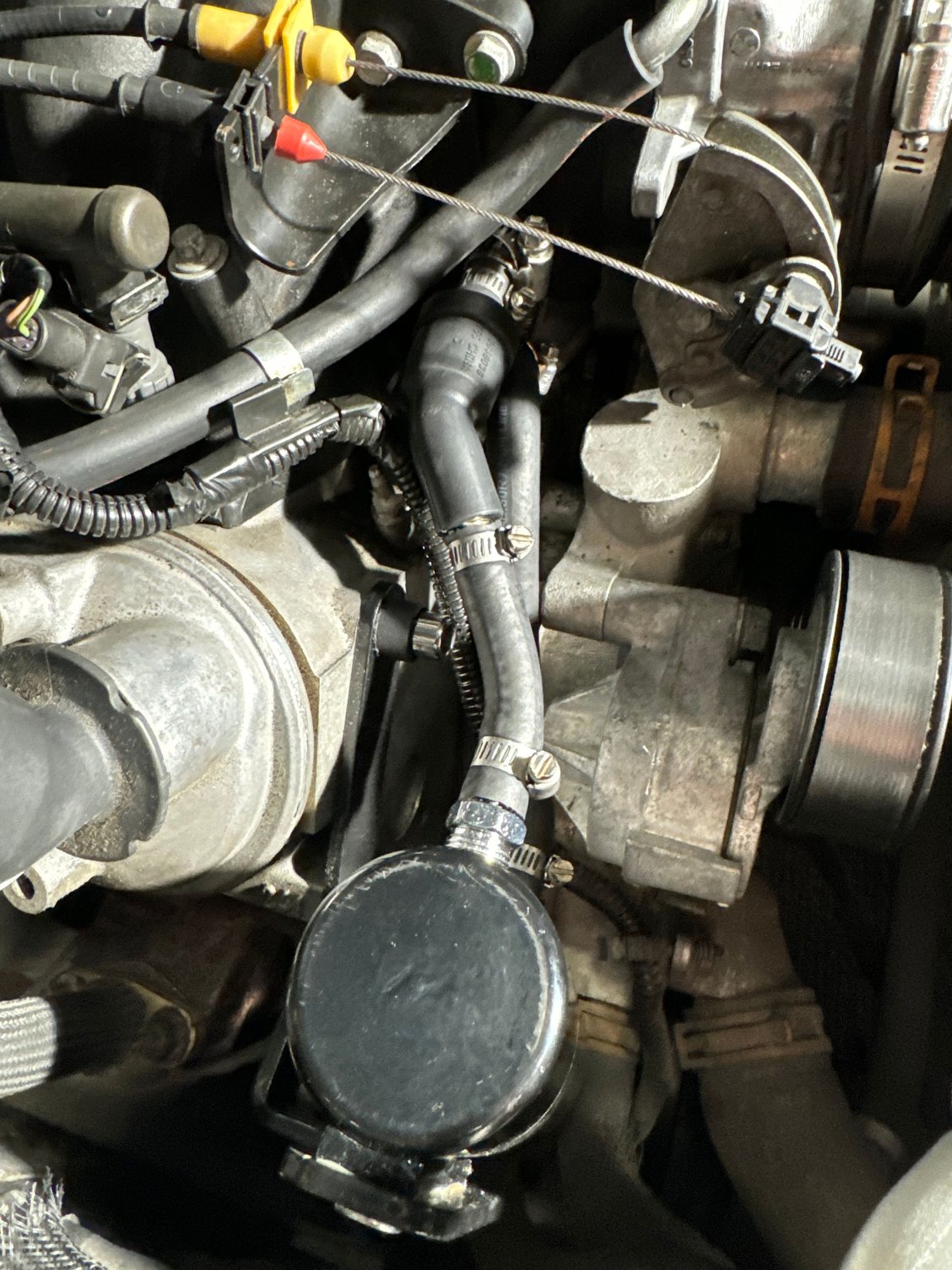

My saga continues. No detonation at WOT which is the goal I had among all this of deep cleaning my intake manifold and intake port area. I swapped a new LS6 valley cover while I was doing all this during my most recent intake manifold removal. Still getting a knock sensor code, it’s bank 2 now, which I don’t know how is possible since I tested resistance and voltage with a multimeter even after they were torqued and connected to the harness. Now additionally i notice I am idling a little high, around 1,000rpm, and when I come to a stop while driving and push the clutch in the rpm’s float at around 1400 for a few seconds and then drop to 1000. Getting code P0507 for high idle. I did break the evap elbow on my last install and am using 1/4” fuel tube on that connection to my TB now, could that be the cause or is something else likely causing the high idle and the Rpm float? Searches suggest it’s a vacuum leak somewhere, but all hoses look fine
edit: fairly certain it’s somewhere in the PCV:
-if I isolate the PCV system by removing the clean air line from my TB and cap the TB barb and remove the hose going from my catch can into my intake manifold and cap the intake barb, idles normally and doesn’t hang
-if I attach the clean air line from my TB to my passenger side valve cover barb and remove my catch can by having the valley cover connected directly to the intake manifold barb with a fresh line of hose, still idles high and hangs
-if I attach the clean air line from my TB to my passenger side valve cover barb and have the hose from the valley cover or the catch can outlet going out to the atmosphere and cap my intake manifold port, idles normally and doesn't hang
I'm fairly certain the LS6 valley cover I got should have a built in PCV since it came off a 2004 C5, however if that is incorrect and there is in fact no PCV itself, could that be the issue? If so I can test by connecting my old PCV in the line going from the valley cover outlet into the intake manifold and see if that makes any difference.
edit 2: saw another post searching that says running without a PCV valve itself creates an equivalent of a large vacuum leak, so this supports the theory that my Ls6 valve cover isn’t the model with the built in PCV. I’m going to try installing my old PCV valve into the loop later and hope that fixes it. Still have no idea why I’m getting knock sensor codes though.

I think your idle issue is definitely a vacuum leak, but I have no experience with the LS6 valley cover as I've never installed one. I would suggest that there could also be an intake gasket leak since the intake has been on and off so many times, but it seems like you have found the PCV system to be suspect with your tests above. Hopefully someone with experience using the LS6 valley cover can offer more advice in that regard.

Idle issue fixed by adding a PCV valve into the loop, I’m guessing the version of LS6 plate I bought is the earlier one that didn’t have the valve built in so I needed to add it back. I was able to make it look fairly OEM and clean, I basically put some 3/8 hose on the outlet of the PCV valve and then used a 3/8 brass coupler on the inlet to join it with 3/8 hose to get female ends on both side as required, and used clamps for good measure on every fitting.

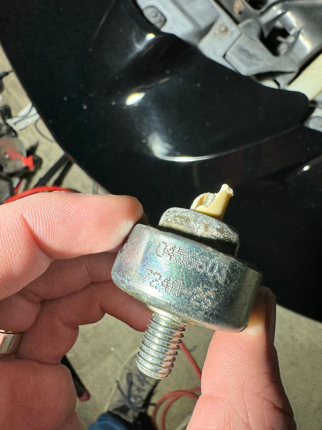

Sort of, they don't look atrocious but they don't look great either, and the plastic connector was so brittle that it crunbled when I removed the original harness. If I do take this mf'ing manifold off again I think I may try AC Delco knock sensors based on other threads where people said it was the only thing their car would accept. Surprising since Delphi is not junk, in fact prior to 2017 they were a division of GM. Photo of my old sensors:

Originally Posted by cascadesys
...Surprising since Delphi is not junk, in fact prior to 2017 they were a division of GM.
Agreed. Delphi was the OE assembly line supplier for many parts on these cars (from the fuel pump to many of the electronics), so I'm surprised it wouldn't be equal to or better than what is sold over the GM parts counter today. But, the fact remains that you're still seeing a code, so if the current AC Delco ones are the answer then I guess it is what it is. Just sucks that you have to keep pulling this thing apart.
