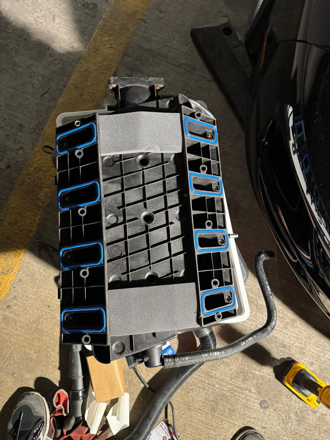

Thanks, I did do brand new gaskets on the intake manifold and checked to make sure they were flush and uniform. Here’s a photo

I really appreciate everyone’s suggestions, I might be in the clear on the misfire. After sleeping on things I took another look at number 7 this morning and realized that the retaining clip on the number seven injector was rotated 90° and preventing the plug from going in all the way. I reinserted that,
I’m still getting the codes for both knock sensors, so I’m guessing I will have to pull the intake manifold to check the wire and work on that.

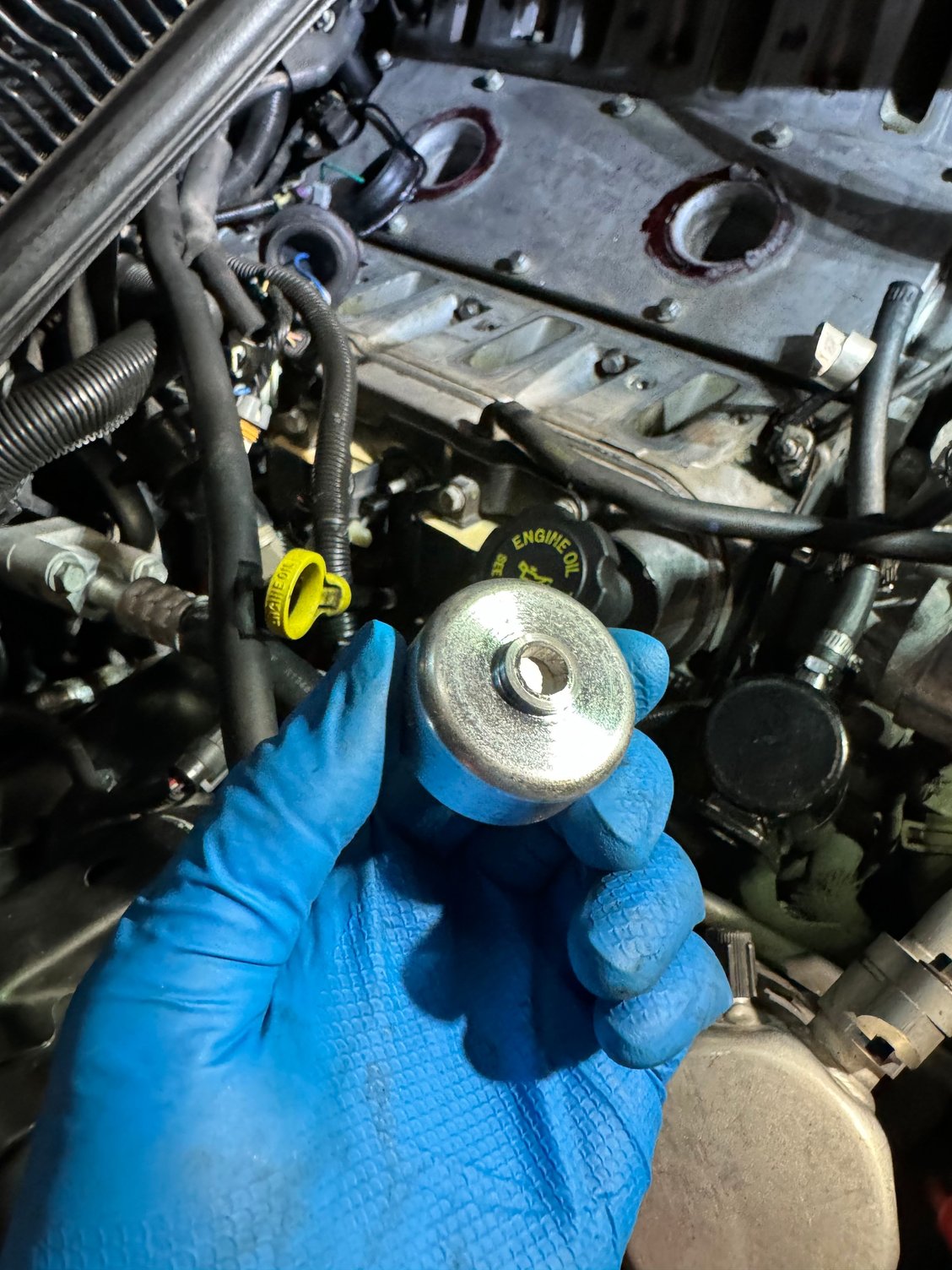

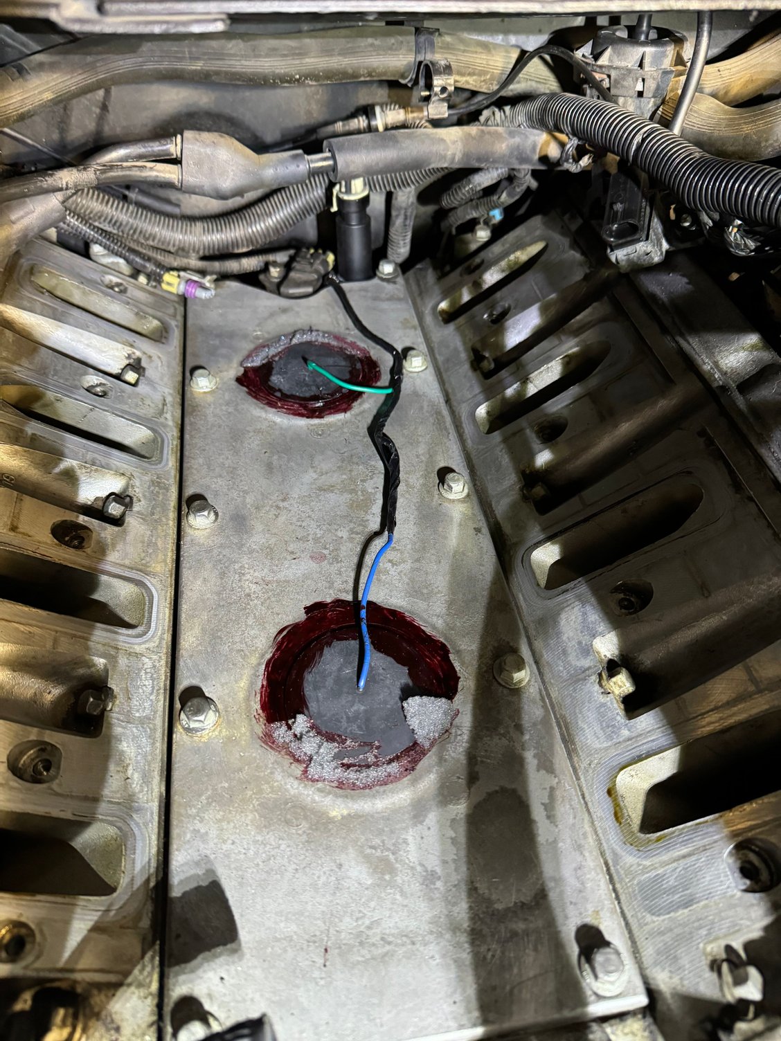

I pulled my intake manifold, here is what my knock sensor harness looks like. I don’t see anywhere that looks crushed or pinched. I tried torquing them further and the threads snapped off

Damn man, that sucks. I've heard even AC Delco sensors can be crap, that only actual genuine GM ones work. I was lucky and had a pair of brand new ones available, the ones I'd purchased at the parts store were junk and I had to redo them after 50 miles. ICT billet makes relocation brackets so you no longer have to pull your intake to change them, but I'm unsure if they'd work on an F-body: https://www.ictbillet.com/ls-gen-iii...9-lq9-lm4.html

Were they GM sensors? If so, hard to imagine that both sensors failed immediately out of the box like that. That's why I still feel that something must be up with the connectors or harness somewhere along the line. If they were not GM, then that might be the problem.

I just put two new ones in (Delphi) and got a 3/8 to 1/2 adapter to run my 22mm socket off my 3/8 torque wrench and torqued it to 132in/lb (11ft/lb) and got clicks this time on both. It’s possible I overtorqued them last time, my torque wrench shows all the way down to 11ft/lb but it’s possible that it doesn’t go that low. I cleared the codes and fired it up, so far so good. Will take it for a drive tomorrow and pray these don’t return.

Just took it for a test drive, P0430 has returned (Catalyst) as well as P0327 (Knock sensor 1 circuit low bank 1). So the good news is that one of the knock sensor codes is gone, but the second is still there, which means the intake manifold has to come off yet again. Very frustrating. The knock sensor wire harness looks fine, so I'm not sure if my next troubleshooting should be to replace Knock sensor 1 again or the harness. I've been considering a full exhaust which will solve P0430 but this knock sensor issue is driving me bonkers.

I would drive it a bit more first, make sure the code for the other knock sensor doesn't come back before assuming it's just the one. There could still be a wiring issue, something that is marginal and will, in short order, show the other code as well. It would suck to keep taking this apart and guessing at the cause. If the other sensor doesn't trip a code after quite some time, then it's probably not a larger issue with the harness that would go beyond the connector for the one sensor still showing a code (or just a bad sensor itself).

I just checked my factory GM service manual, it says 15lb-ft for knock sensors for an LS1. But I don't think being at 11lb-ft would be the cause of a P0327. I'm not sure what the normal ohm reading would be for this knock sensor, I've never checked. But you can certainly check for continuity at the connector(s), wiggle the harness around and see if you can cause some changes in readings. But if the problem is the connector itself, then the harness might check out fine until it's plugged into the sensor. I guess you could always try replacing the sensor again, see if you can exchange it under warranty.

Your guidance has been very helpful on this journey, thank you. I think I had some debris in the threads of bank 1 and that was causing issues, because when I went to back it out the nut of the sensor spun inside of its housing. I had to remove the valley cover to twist it out with channel locks, and while I have the valley cover off I decided I may as well go ahead and do the LS6 valley cover and PCV mode while I'm this far. I exchanged my Delphi sensors for two brand new ones, tested them both with a Fluke multimeter and get a solid 100.8K ohms of resistance on both, so these should not be DOA. I also got a brand new harness to be sure. I'm going to install the LS6 valley cover tomorrow evening, install both of these and torque them to 20NM aka 180in/lbs aka 15ft/lbs, reinstall everything, and hope for the best. I looked at the plug for the knock sensors where it connects to the rest of the car harness and everything looks fine.
