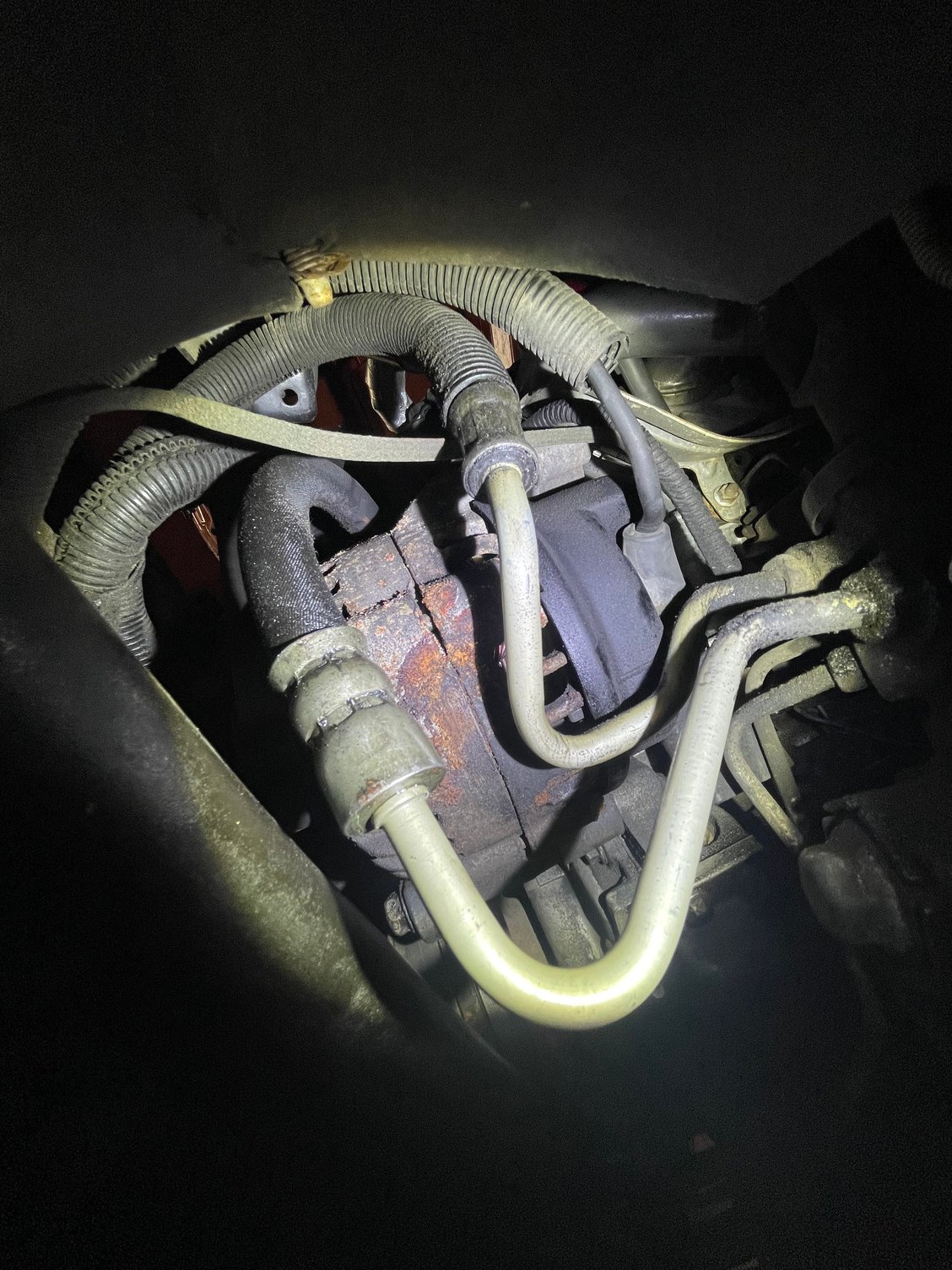

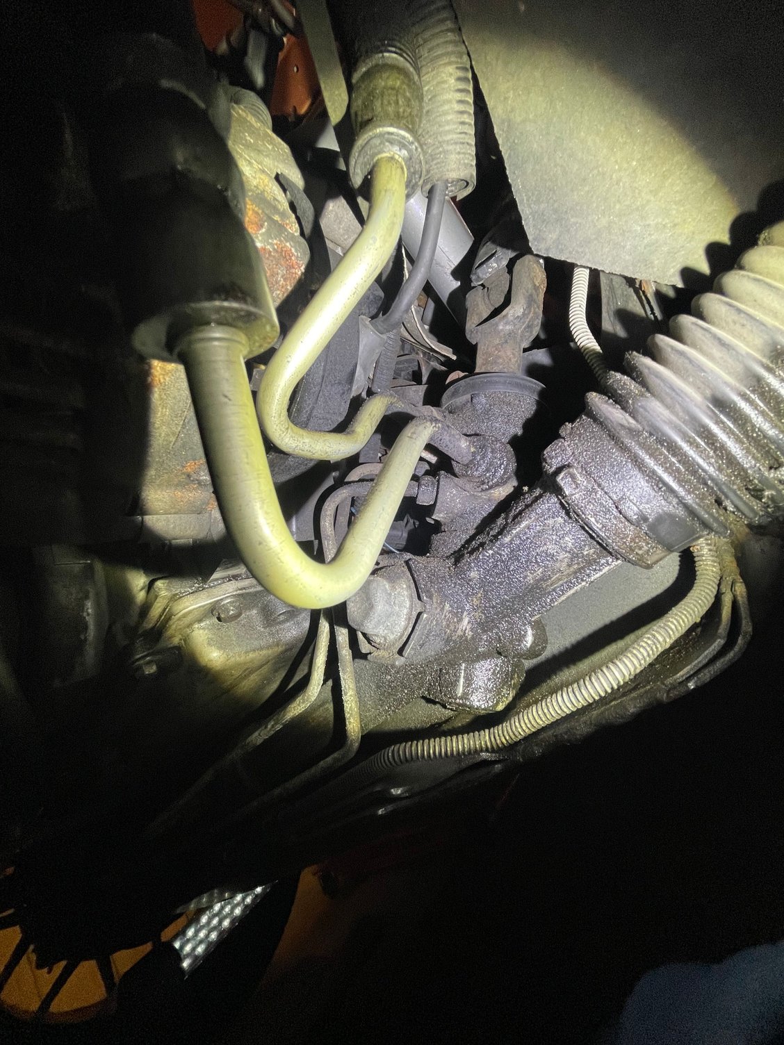

power steering is a little low but looks like it’s been leaking for a while, just don’t know where from, although the passenger side hose from the reservoir definitely seems to be an issue. That’s the one on the left of this photo looking wet

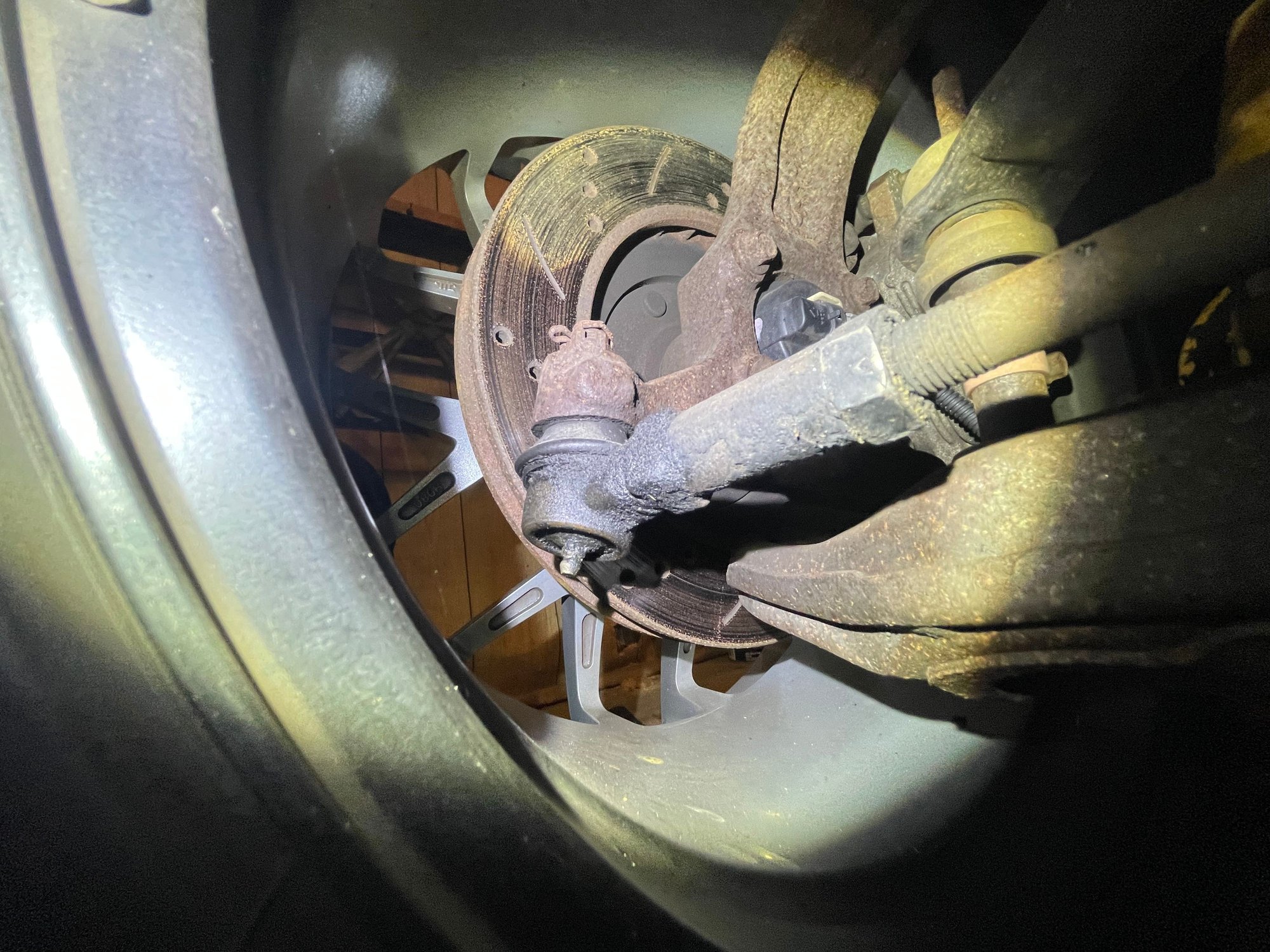

Not sure what this bar is called that controls the steering that’s covered in grease, also not sure if it’s actually leaking or being leaked onto, although the compression fitting (I think) looks to have an excessive amount of build up around it so that may be a culprit. Grease continues on to the underside of the boot shown in right side of photo.

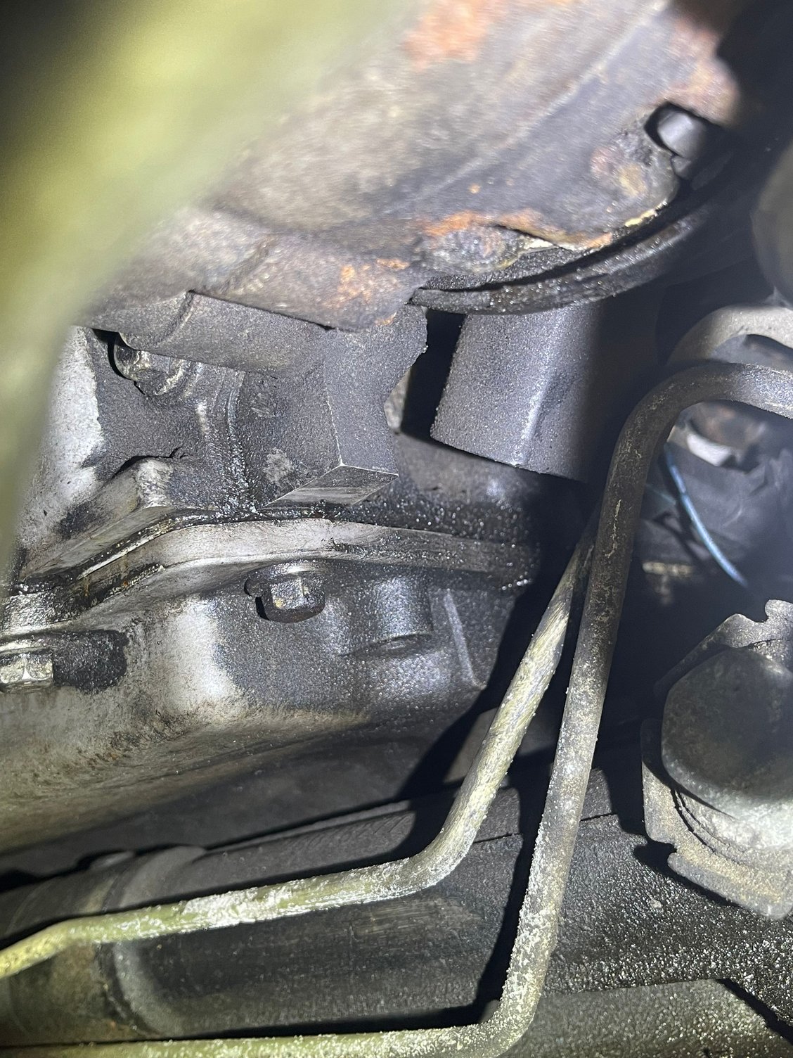

Oil pan possibly leaking? I don’t notice any excessive loss of oil, although I really don’t drive it enough to where I would. Find it hard to believe it’s NOT leaking tho based on how the build up looks here…

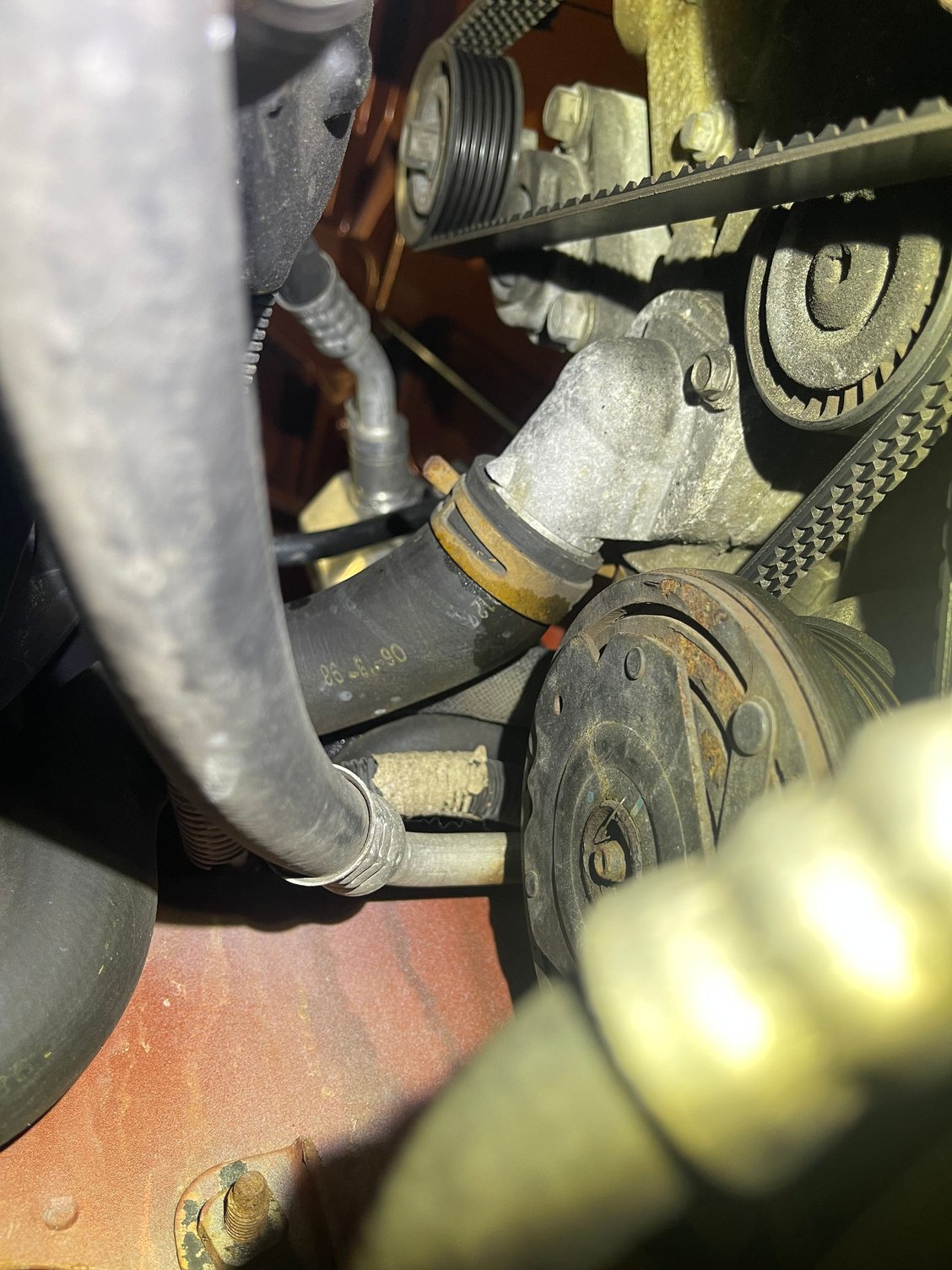

Radiator hose looks wet. This looks to be a welcomed small leak. Not really sure how it would leak tho unless there’s a tiny pin hole in it or something. Front passenger wheel. I’ve never greased these. Can it be leaking from the zerk itself? There’s build up quite a ways if that’s the case. What needs to be fixed here?

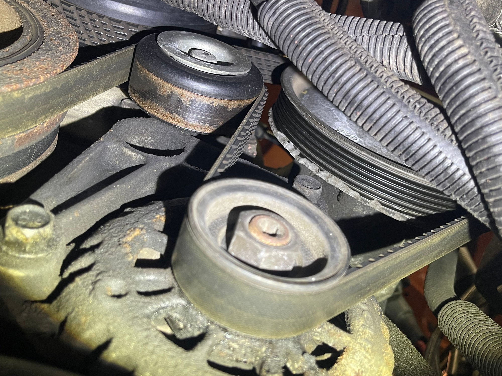

Noticed the (i think this is the harmonic balancer) has a bunch of chips missing it out of the side of it. Have no idea how long it’s been like this, possibly since I bought the car.

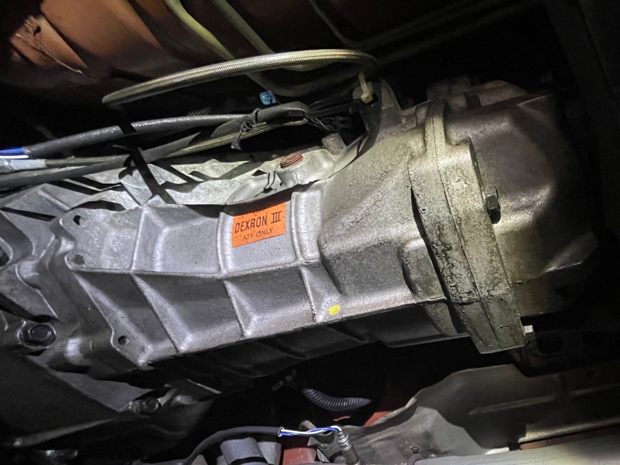

Back side of transmission. I don’t even remember if there was a gasket in here, or maybe rtv gasket maker is what was called for here? Can’t remember but certainly not looking forward to fixing this, as it also definitely appears to be leaking.

First pic moisture on the power steering lines doesn’t look bad.
second pic moisture from the steering rack doesn’t look bad.
oil pan looks like most of them
radiator hose might have a pin hole. It’s not wet where the rubber meets the metal.
tie rod end looks like most after use
that’s the power steering pulley. Pretty nackered up, wonder how that happened?

This all normal. The rack and pinion leaks slowly over time as does the pressure hose that feeds it. The pressure hose has very high pressure hydraulic fluid in it as does the rack and pinion. If it bothers you, you can clean this stuff up with brake cleaner and a rag. No need to worry until you notice drips underneath the car or the grease turns into something that looks like a squirrel that has been dipped into a vat of motor oil.
The one thing that WOULD be worth doing if you haven't before is flushing the P/S fluid from the system. The best method I have seen is to:

Your oil pan gasket might also be leaking. Again, this isn't a big deal and is normal. (Unless you see drips underneath the car.)
This could be your water pump going bad. There is a weep hole on the bottom of the pulley shaft that drips onto the A/C compressor. It could be flinging fluid up onto the hose. You might move the clamp, clean everything up and watch it to see if the pattern develops consistent with this and if there are other drips. Look at the bottom of your starter, sometimes the weeping gets over there also.

This is a normal tie rod end. Wipe it with a rag, Grease the fitting and you are all set!

That should be the pulley on your Power Steering pump. It's plastic. Take off the belt, rent a proper pulley remover, and replace. You can get a new plastic one or there are aftermarket metal ones on the market.

Nothing there looks shocking, bad or out of place for a car with 100K miles. Wipe with brake cleaner and a towel.

You might also start thinking about a new P/S pulley. That one isn't going to get better by itself.
