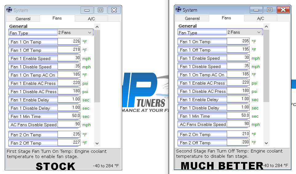

You don't "have to".. but I always turn them down lower even on the stock T-stat cars. It helps greatly. I've never installed a 160 in anything I own and I live in Florida.
Example, this is the stock tune compared to my changes in my 2002 C5Z06. Factory set to have Fan 2 come on as the Engine is in meltdown...
