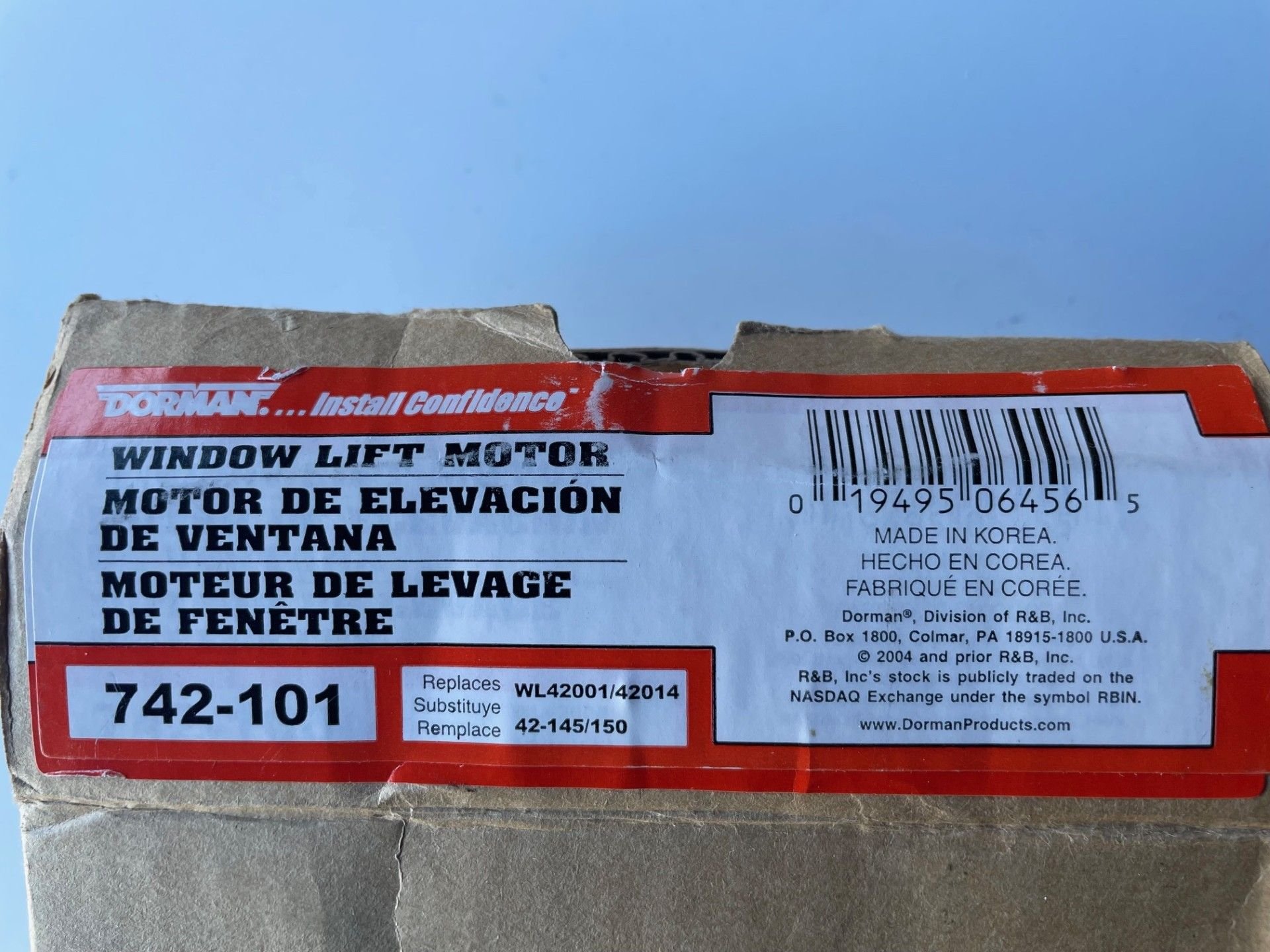

After four years of my driver's side window not working, today I finally did the shbox method and changed out the non-working OEM motor with this motor:
I was so excited to see the window go down and then up again. I wanted to take a video to share my joy with others and when I went to put the window back down and up, I noticed it was slowing down. In fact, it slowed down so much that it stopped like the dead OEM motor after maybe 3-4 round trips. Even after letting it cool down, it barely goes up. So disappointing !

I just want to be 100% clear-On 12/11/2024, I installed a brand new window motor and I can tell that it isn't working correctly. Yesterday, 12/12, I tried a brand new Dorman, driver's side window switch. It didn't fix the problem. At this moment, one or more of the following things are wrong:
1. new window motor is defective out of the box
2. wiring is bad (corroded, too much resistance)
3. window mechanism is sticky with too much mechanical resistance
25 or 30 yrs ago, I don't think that we consumers had to deal with as much defective stuff right out of the box. Today with what I call the "china effect" everything is of low quality and it's common to find brand new stuff right out of the box that doesn't work right. Perhaps my new motor is bad. I like your suggestion of trying one of the rebuilt, Cardone units. I found them here:

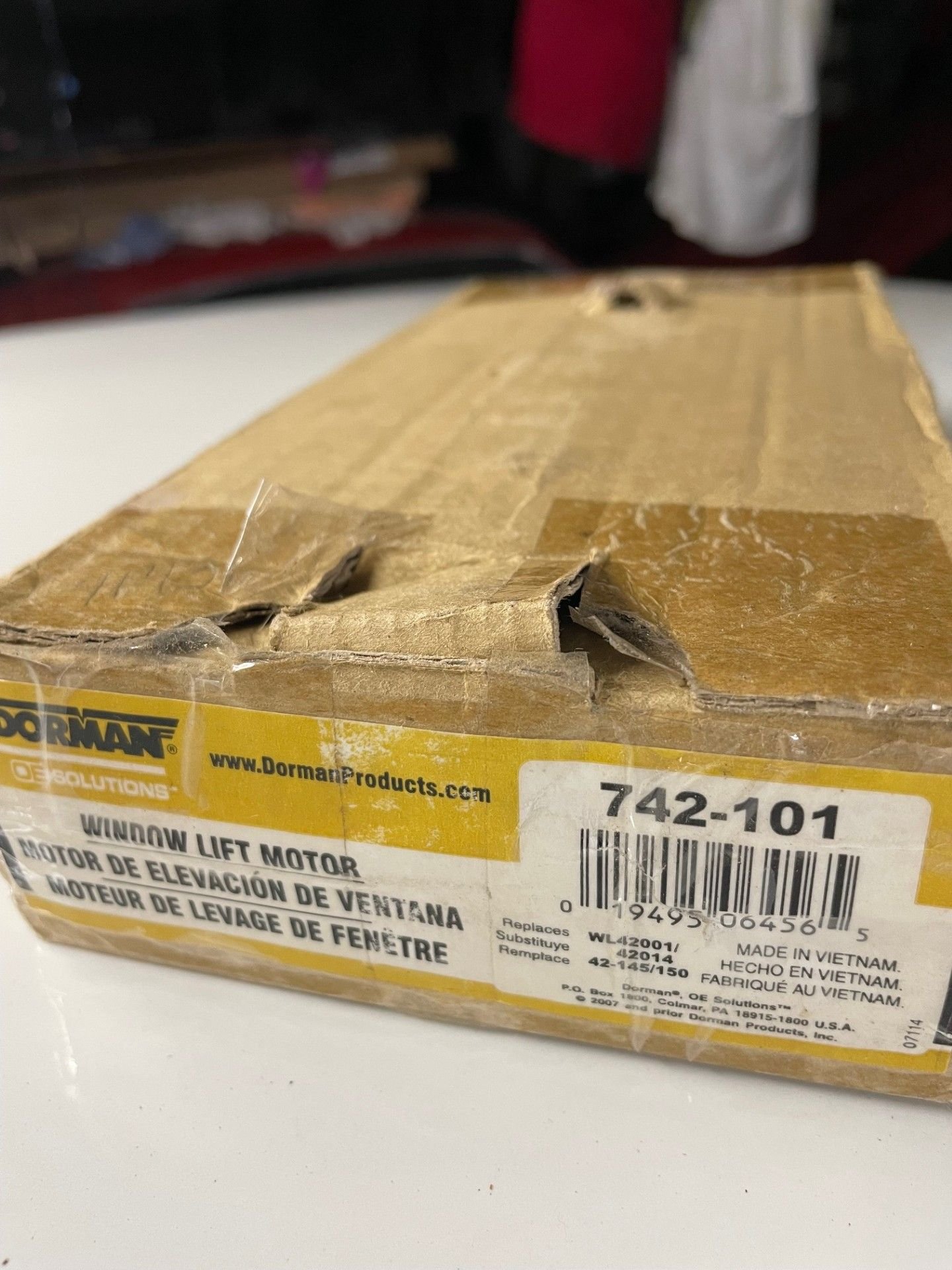

I made good progress today. I had another, new old stock Dorman window motor. This one was made in Vietnam vs the other one that was made in Korea.
I hooked up some loose, 12awg wires to the motor to test it and it tested good outside of the door. I left the loose wires on and insatlled the Vietnam motor into the door. I then connected the loose wires to my battery and the window went down and then up. I did 3 round-trips and the Vietnam motor had no problem with it.
Next, I wanted to see if the car's OEM, 22+ yr old wiring could run the motor. I removed the loose 12awg wires and installed the OEM window motor wires. I ran the motor up and down three times. It was slightly slower than the direct wires but it made the three round-trips just fine. I could tell this Vietnam motor has a lot more muscle than the Korean motor. At this point, I called it success and put everything back together.
It appears that some of these new motors and just junk right out of the box. If I were going to buy a new motor, I'd buy the rebuilt Cardone motor that I previously linked in post #10.
