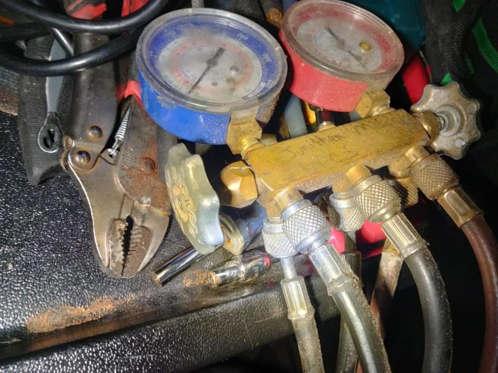

I do have a old set of household AC gauges
I got from the junk yard a few years ago didn't pay much attension to the quick connectors not being there at the time I thought car an house were the same.
can I buy just the quick connects for low an high and a can piecer in order to use the household gauges or should I just buy a cheap set of gauges?

I thought the vans AC compressor was down low on pass. Side like the LS1s.
Now I know it’s on top front driver side just like the 02 an older 5.7 vortex.
I will observe the clutch to see if it engauges, will also physically feel the clutch.
Then procede to replace the known to fail seals.
1.swap new oroface
2.swap fitting on same tube oroface is inside.
3.swap preasure switch O ring or whole PS
4.swap scrader valve inside preasure switch
5.swap scrader valve inside dryer.
How doe’s my plan sound. Sure hope the compressor isn’t falling apart. Bc if it is I’ll replace everything compressor/condenser/lines that connect the two/ dryer/ oroface basicely everything except the evaporator bc the oroface protects it an I don’t want to completely disassemble the whole dash. Hows my plan look.
Evidently these GM seals are known failures.
