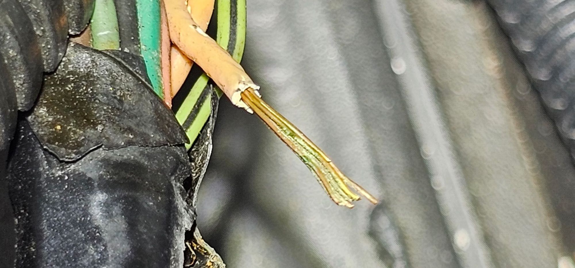

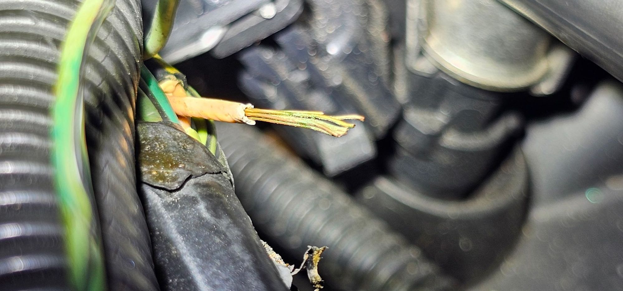

The photos show corrosion on the bare wires after stripping them for repair. I'll attach from my phone.

Old Jul 25, 2025 | 03:48 PM

What happened to initially compromise the insulation (i.e. why was it being repaired in the first place)? Was there an event with rodents, or did something partially melt from a short or contact with exhaust, etc.? Was the car in a flood event?
Just trying to figure out how deep the issue might run. If it's just one wire or one area, I don't think you need a whole new engine harness.

It's never been flooded... once in a while I'm forced to drive in heavy rain. Hydralocked the original engine in roughly 2000. The car spends most of its life outdoors. No known rodent issues. Had a fire ant infestation years ago. A couple symptoms happened about the same time early this year... brake master coupling broke, emptying reservoir. But after the repair it still ran rougher than normal. A few days later it seemed down on power, thought it was related to recent brake repair. Had noise in the B2 valve train, found a loose rocker arm & broken aftermarket rocker arm bolt. I found both ends of the bolt in the top of the head and repaired that. Still won't run so I tow it back. They find a few different things... broken cam position sensor, damaged knock sensor connectors due to header heat, 'stretched' Hinson C7 timing chain, shorts in the #4/#5/#8 injector/ignition harness, etc. While putting the car back together they stumbled across the harness concern.
