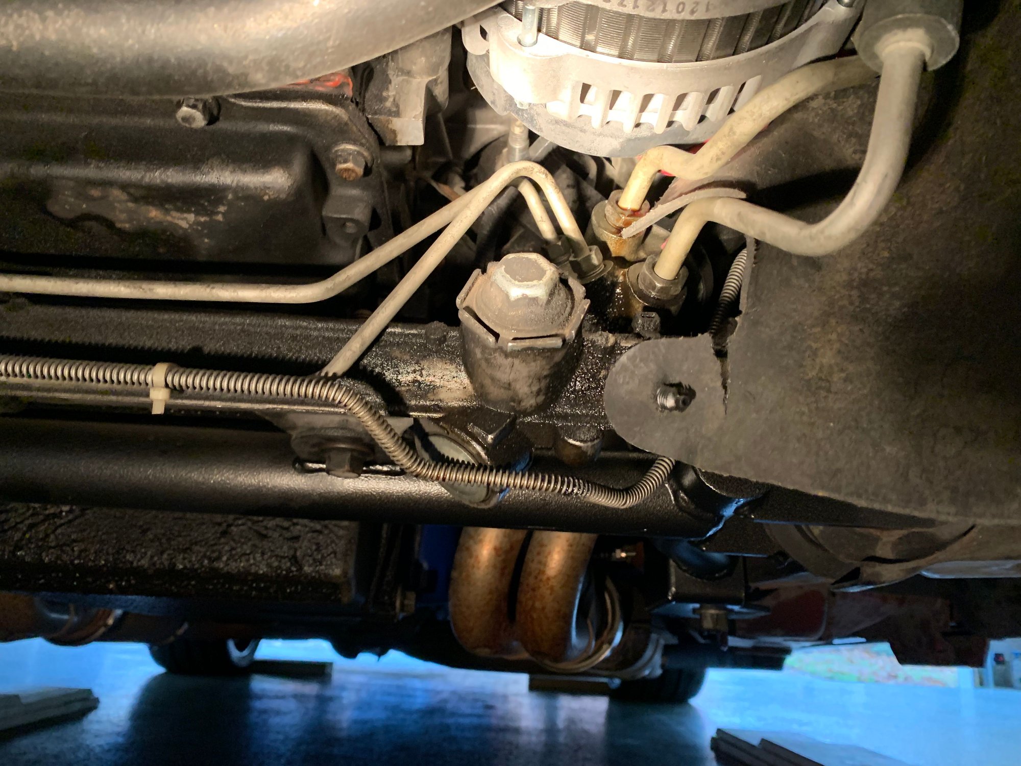

My return line is leaking right at the fitting in the rack. (Looks like my truck alternator has been pushing against it and it finally failed). Rather than buying the stock return line, I want to take advantage of the opportunity to get rid of the factory cooler and add a frame-mounted one. I'm going to replace the fitting with a 90 degree turn to clear the alternator and buy a generic line to go from the rack to the cooler and then the cooler to the reservoir... What fitting do I need to replace the one in the rack though? :/

Thanks Wssix99. Only way I may be able to make that work is cutting the hard line just as it comes off the rack and clamping the bypass hose right there.. The alternator is pushing on the hard line and (I'm assuming) caused this leak. I'm hopeful on your suggestion for just a new o-ring fixing it, but I need to address the hard line being pushed aside as well.

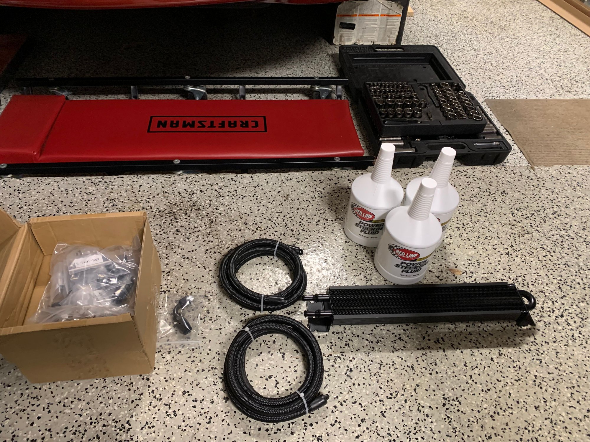

Thanks for the replies all. I don't have pics of the solution as of yet, as the parts haven't all arrived. I ordered a PQY power steering return hose kit (with a new fitting & 90 degree bent hard line) and a Derale frame rail cooler. Since I'm touching the return, I'm going to go ahead and at least route around the crappy stock cooler. I'll worry about replacing the coolant hose at a later date.
Here's a pic of the leak and the hard line up against the alternator. The alternator has been in there for 5 years, so I guess it has just been a ticking time bomb since then.

Parts are here...hopefully I'll get some time this weekend to get it flushed & put back together.
