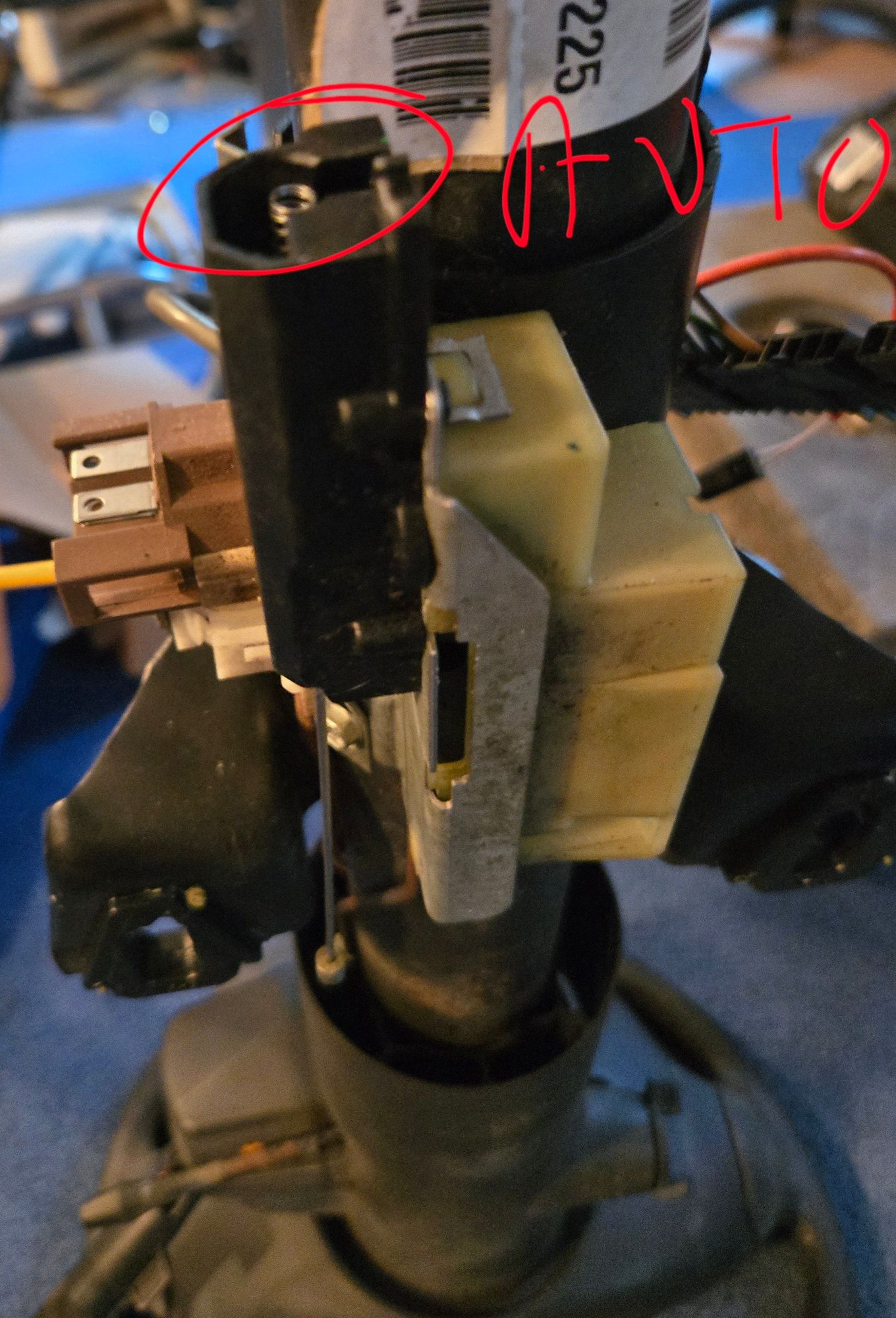

2002 ta, is the only difference in columns the ignition switch for the auto lockout?

The main difference is the ignition lock mechanism. The automatic column has a shift interlock to prevent shifting out of park without the brake, while the manual doesn't. The core column itself is otherwise very similar.

Some of the Manual stuff has a push button on the Key Switch.
You know that's a Solenoid connected to the Shifter that's in the Center Console, right..
There's no Column Shift 4th Gen Fbody.
