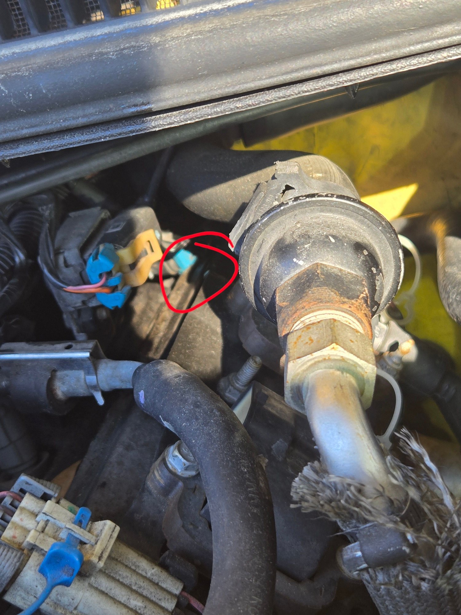

Old Dec 20, 2025 | 11:52 AM
Daveone23's Avatar
Joined: Aug 2025
Posts: 28
Is this the connector for the knock sensors, green and blue wires.
Old Dec 20, 2025 | 01:18 PM
RPM WS6's Avatar
LS1Tech Administrator
Community Influencer
Posts: 34,661
Likes: 2,592
Knock sensor is not the reason for your misfire, that's a separate issue. Knock sensors are located underneath the intake manifold and would require manifold removal to be replaced.
Address the P0300 as outlined above.
