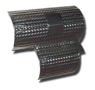

Lingenfelter makes a carbon fiber one. Runs $79 on their site and $67 on ebay.
Jegs carries thermoctec's universal aluminized starter wrap for $29.

The Lingenfelter starter heat shield isn't carbon fiber. It is two layers of stainless steel with a high temperature ceramic heat shield material in between.
Carbon fiber wouldn't make a very good heat shield since carbon fiber conducts heat fairly well and the epoxy resins used to bond the carbon fibers together don't hold up to very high temperatures.
