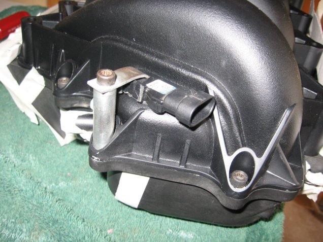

Here's a pic of mine. Zero problems after a lot of street miles and track runs.
Attached Thumbnails Map sensor question with a Fast install-fast-map-sensor.jpg

Be careful with the long bolt method. I did that on my c5 and the clamp hit the firewall breaking the map sensor.

ya, on a c5 the firewall holds the map on.
