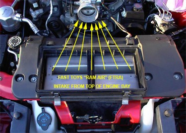

yeah Ive seen people cut the bottoms out for the free ram air mod. Some even used the SLP cold air kit or fast toys under it
fast toys
SLP
you get mor air from this then a SS hood
