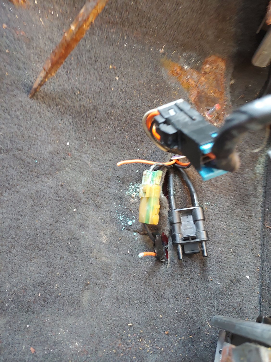

Hi,
Suddenly my both seats stop working... Fuse is ok and there comes electricity in... so any hint where i could find problem?
When gauge power from passenger seat there comes nothing

Default Broken wire
Under the drivers seat there is a connection that may be below the carpet. It has a positive ORANGE wire and a Black wire. My positive wire was corodded through.
