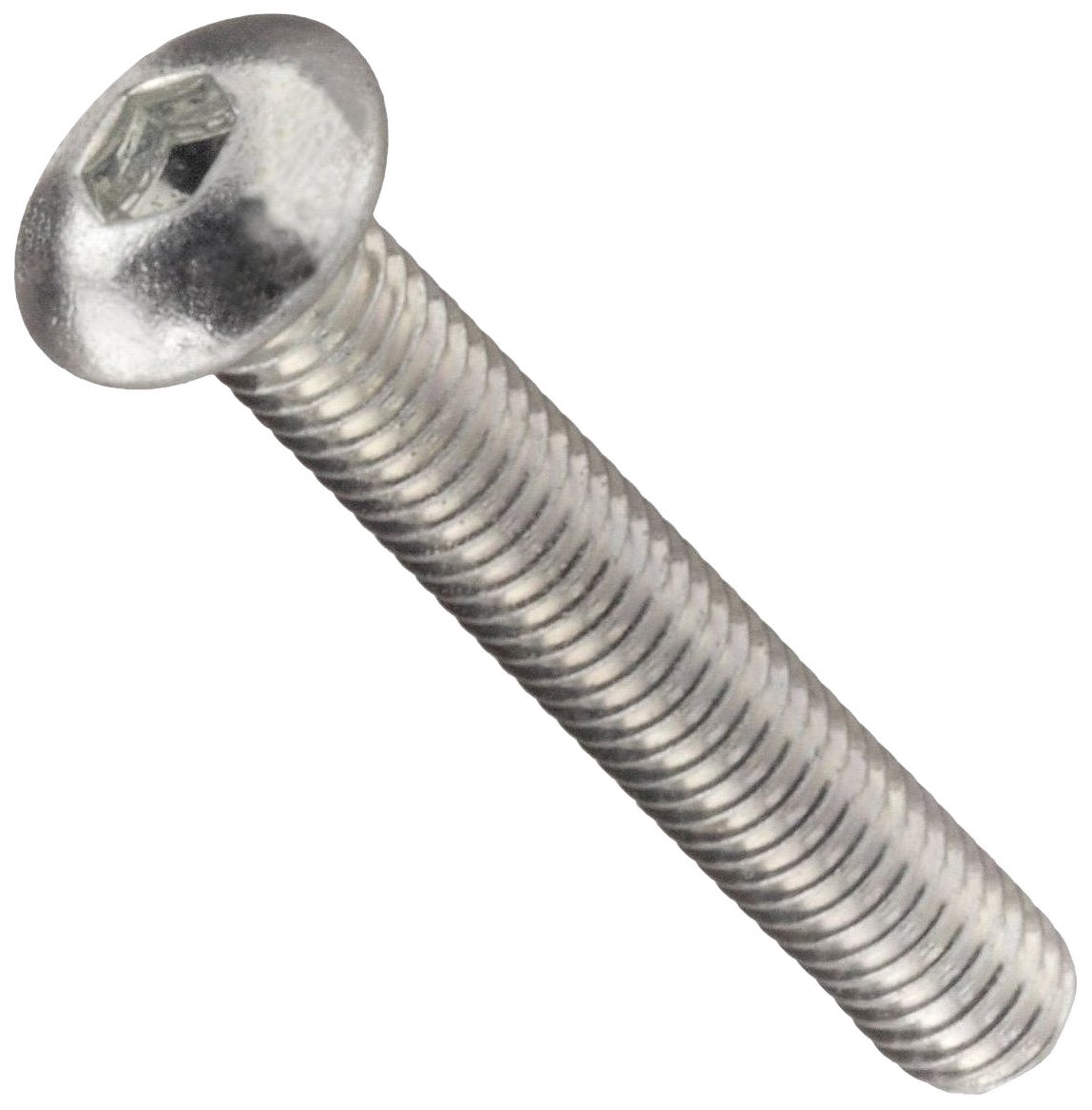

you need to be sure you have ls6 style crossover tubes for the coolant as there is no room under the fast for the ls1 style
you also need to replace the valley cover bolts with the ones supplied by fast which are button head cap screws like these:
