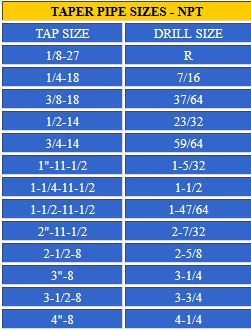

what size hole did you drill in it? from what ive read it doesnt have to be the same size as the threads?
Old Dec 8, 2014 | 10:29 PM
jblankenship's Avatar
Joined: May 2012
Posts: 626
From: Mechanicsville, VA
I believe the sender is 1/8 npt. So I used whatever bit that tap calls for.
