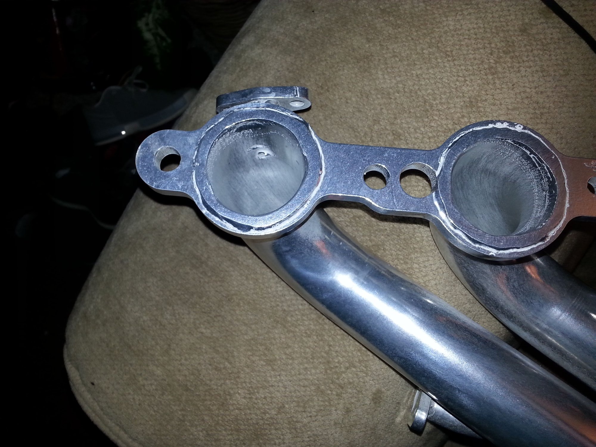

what should I do talk to tech he said it was the design😕 what do some of you knowledgeable mates think....

I resized your pic since it was way too big to see. Is it that the bolt holes are drilled in the wrong place? If so, Hooker will replace those since it is their fault. I am not sure what to see.

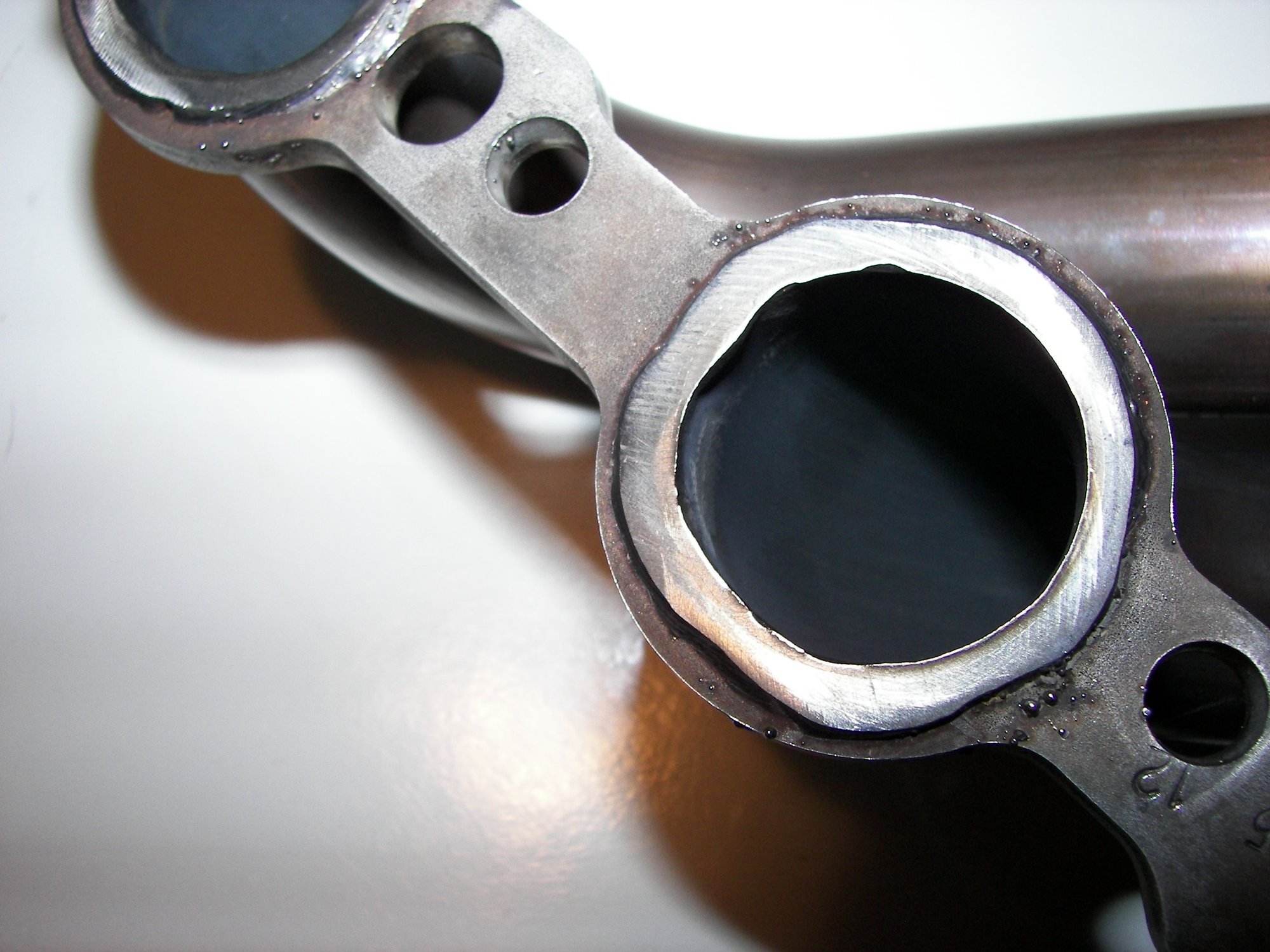

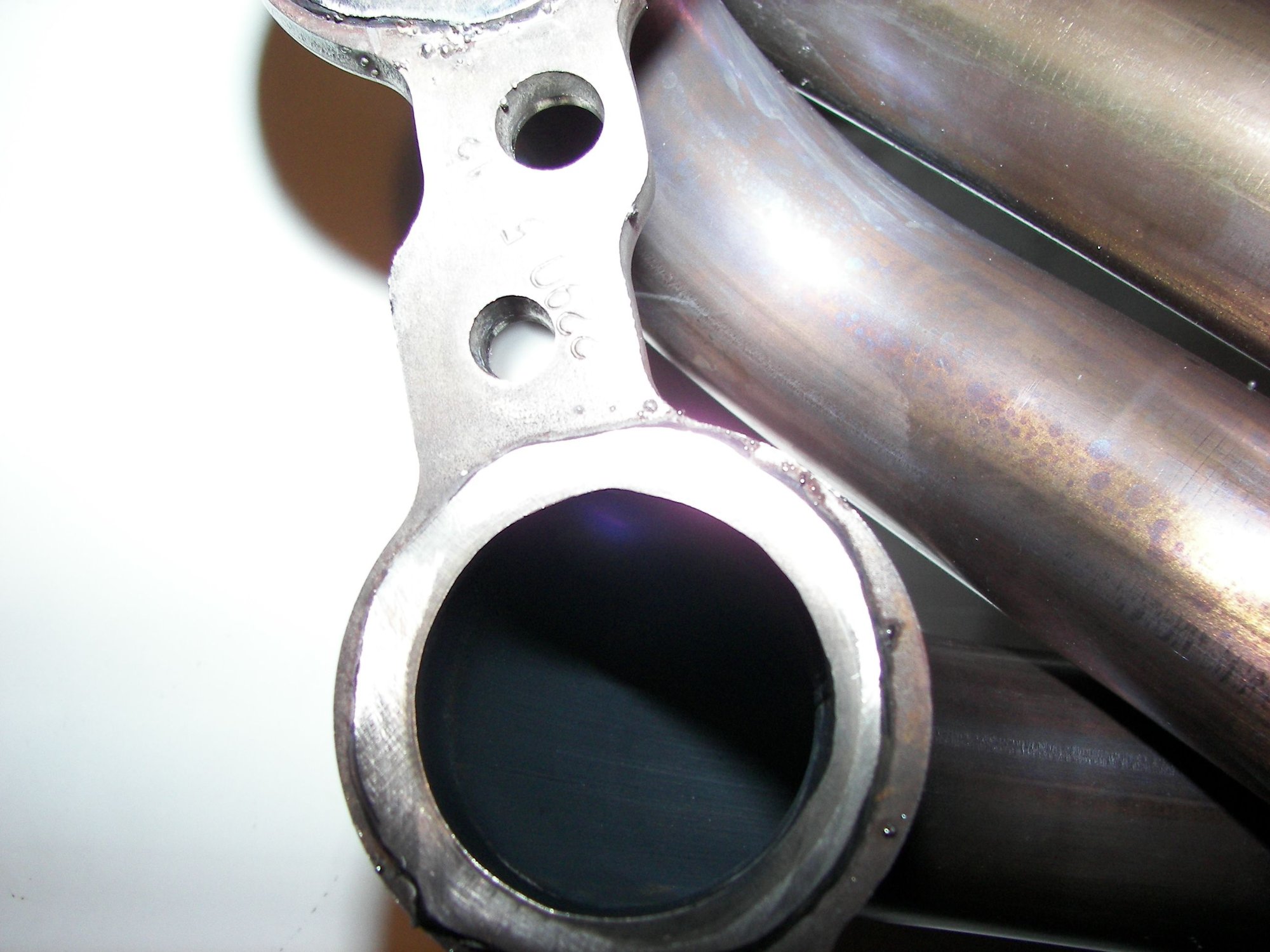

I had 1 3/4 coated Hooker Super Comps, and now Stainless 1 7/8 Hooker Super Comps and they have always been perfect fit compared to some brands. If you need pics let me know.

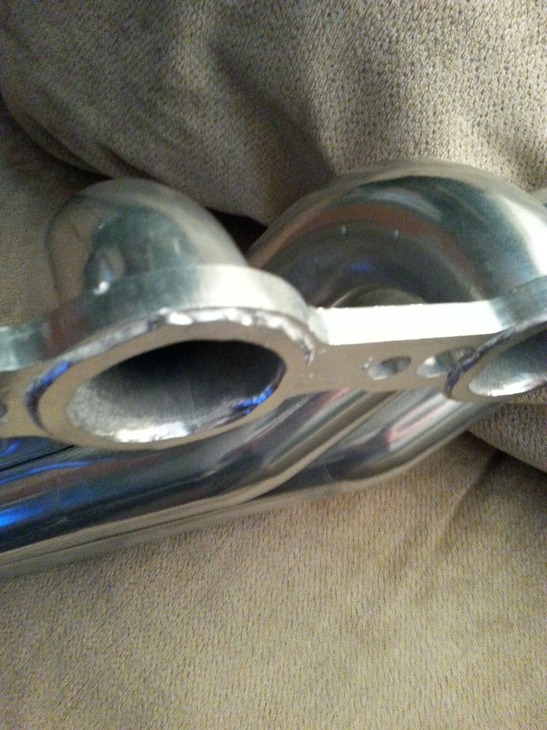

The welds here gos some more pics

They should be milled flat. The fact that they are slightly wavy looking doesn't effect anything.

I see what you are saying now. When I first looked at the pic I saw nothing wrong and was wondering if you were talking about the bolt holes or something. Those look great to me. They put the primaries through the flange and weld it up and then mill the welds so they are a uniform height / flatness so they will seal. You have more of a sealing point than my stainless ones. You are good to go.

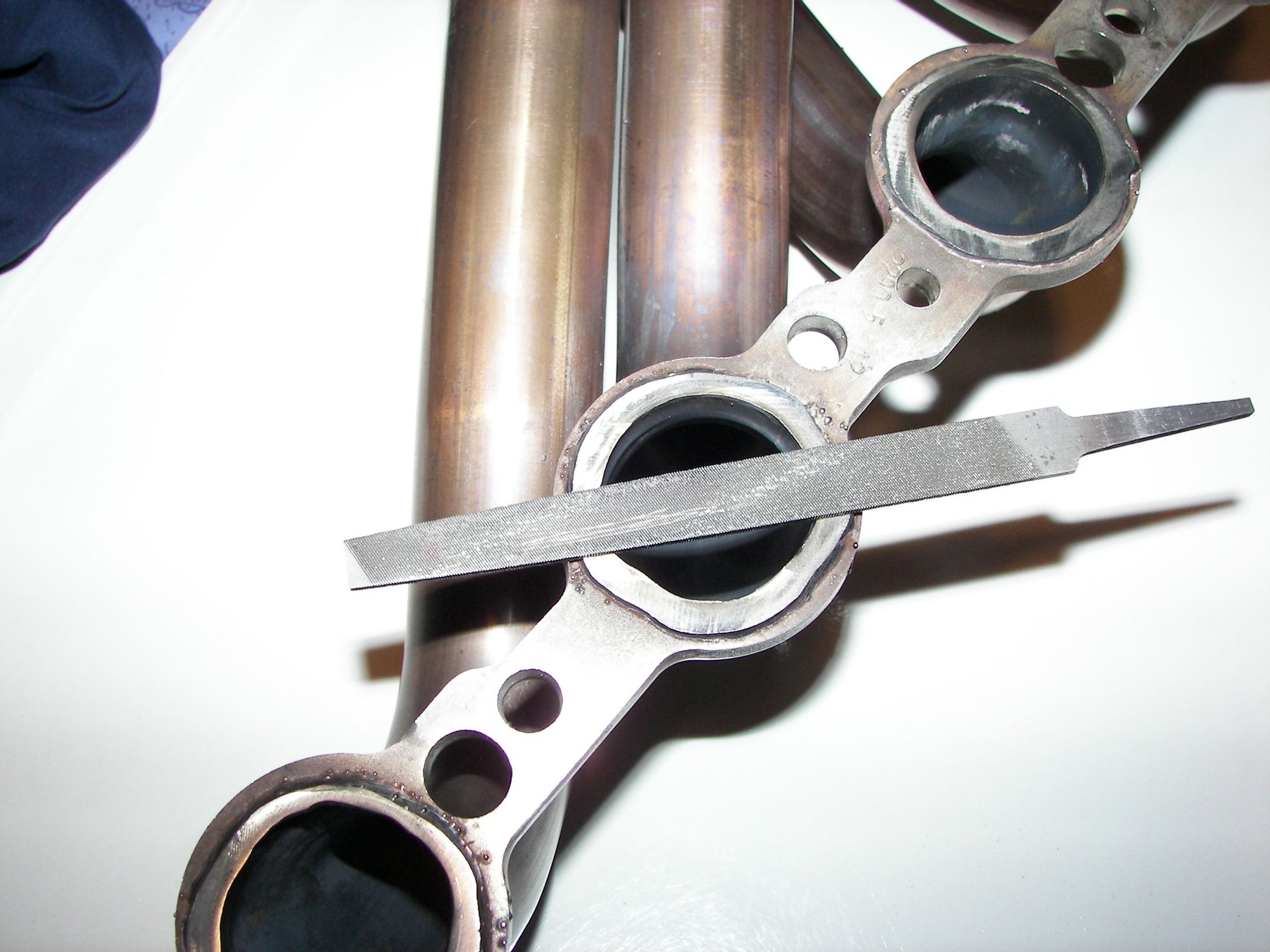

One thing I will advise you on is to take a file like I have pictured across the top of those welds perfectly flat, there will always be something that is higher than others and need to be smoothed out to guarantee a nice seal.
You want to see ugly *** welds, look at your emission hookups at the primaries. Mine were terrible so I chopped them all off and filled the holes in.
