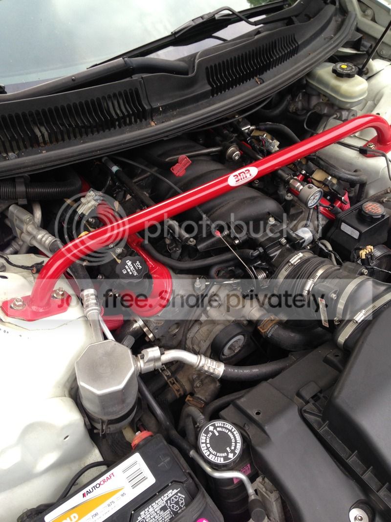

here is mine
see how clean it is around the top of the engine without all that bullshit in the way?

Originally Posted by Majestic9C1
here is mine
It does clean it up quite a bit. That's most of the appeal at this point... Plus I'm in there already, so if it doesn't do the trick, I can always go with a catch can easier down the road.

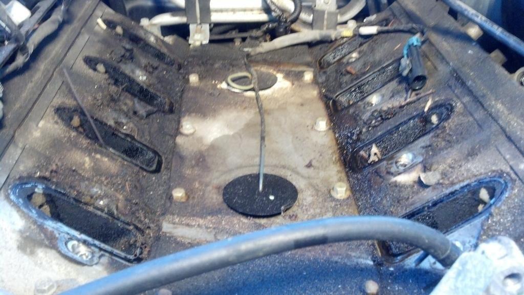

When I got my truck, I installed the LS6 PCV system-and a catch can. My motor had a long ago failed LS1 PCV system. Even with the LS6 system, I still catch a few ounces of oil every month. But my intake is bone dry.

Paul, mine looked that bad as well when I took my intake off for the first time. I've pulled it a couple of times since to inspect, and that LS6 PCV really helps. I still get very minor amounts of oil, and I need to install a catch can, but I've got other issues first.
Bottom line, yes, the LS6 valley cover is worth it IMO

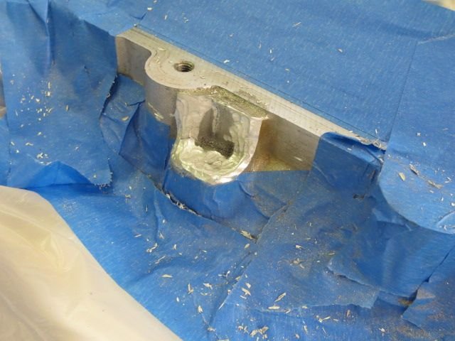

Working on this right now, Just got finished cutting the extra pc on the ls1. I want to keep the 4 corner steam vents any help woul
d be appreciated
