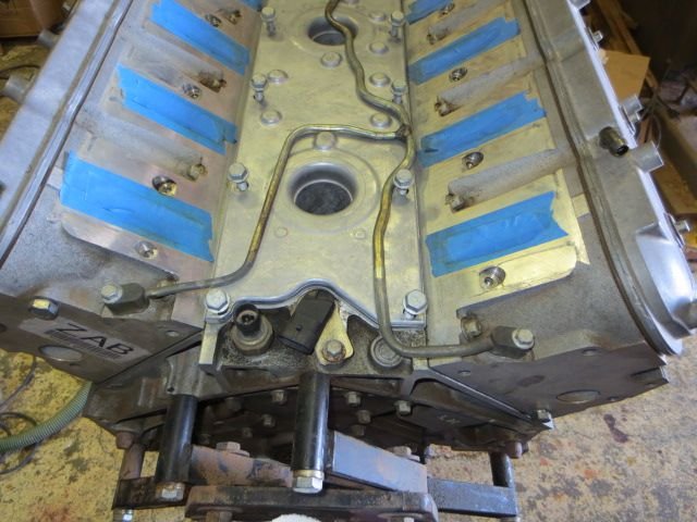

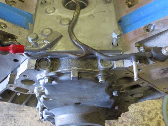

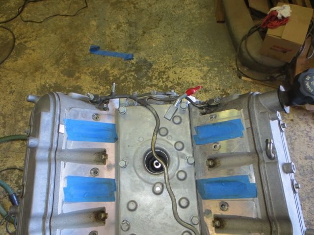

Do you mean coolant cross-over lines?
Old Aug 19, 2015 | 06:42 PM
  #42
shoeboxvette's Avatar
Joined: Apr 2010
Posts: 131
From: Kaneohe, HI
Yup that's them, got it more patience than skills
Old Aug 20, 2015 | 10:45 AM
  #43
Darth_V8r's Avatar
Moderator
Joined: Jul 2014
Posts: 10,450
Likes: 1,873
That's almost exactly how I did mine. A bit more attention on your part, but it worked under the BBK intake. The FAST won't clear, so FYI, if you go FAST, you'll have to get the LS6 crossover

You couldn't pay me to plug the rear steam vents. Fast intake, or not, I would do whatever it takes to retain the four corner venting system.
You can use hard brake line and go around the intake, versus under it. There are plenty of options, and all of them are better than plugging the back steam vents.
