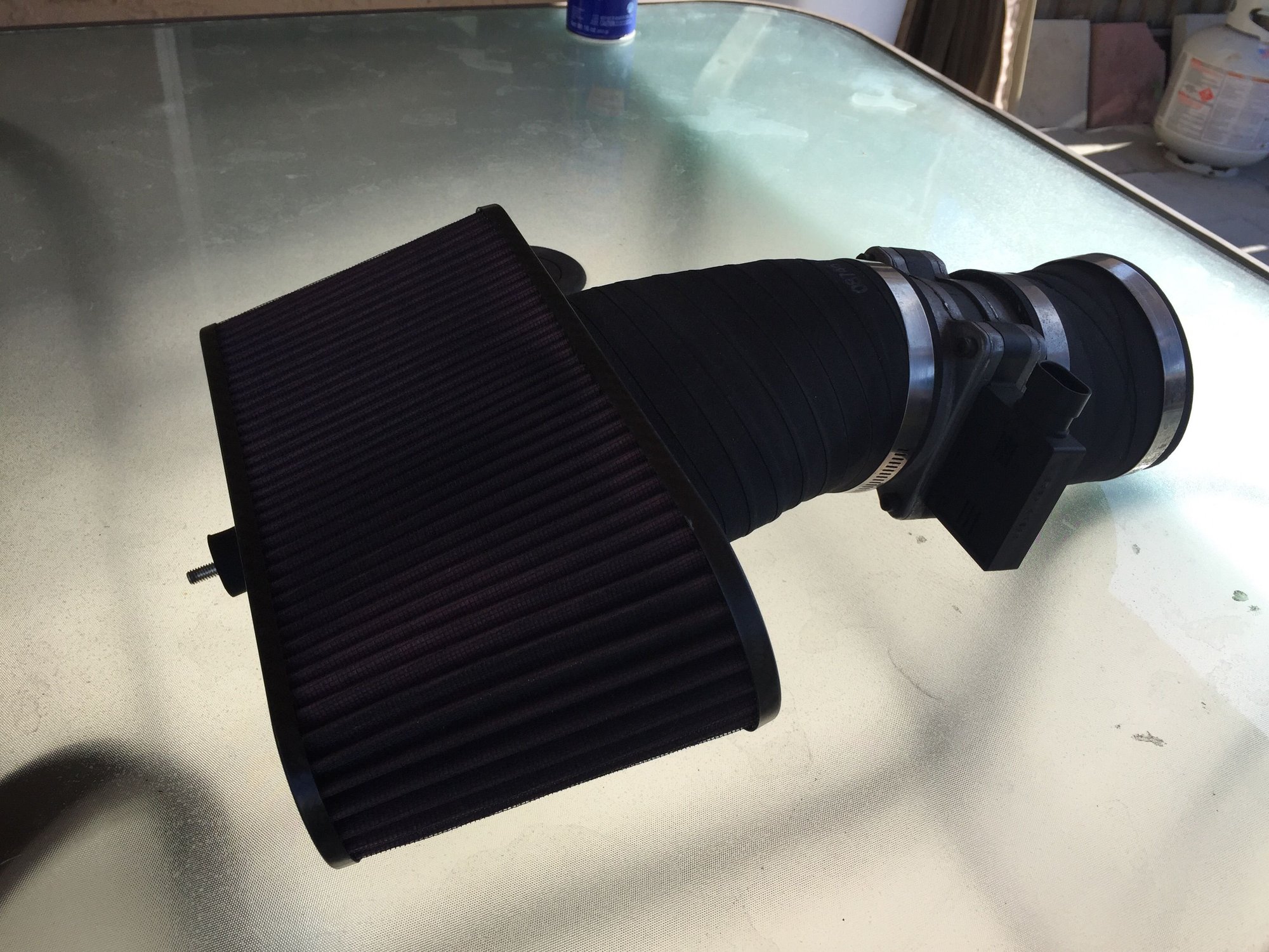

Hello all, I'm currently in the process of building a 408ci 6.7L LQ9 for my 2001 SS. I'm looking at the market for the FAST 92 manifold and about 6 months ago before I knew if be dropping a new motor I bought the K&N 57-3022-2 performance intake for my LS6 intake manifold. Well I called K&N and they said they don't sell the hose to mod the intake for the Fast 92 it's only for stock. So what air filter intake do I need to buy for the FAST 92mm Big Mouth??

You will likely need a short silicone coupler. Your 90mm TB should be 4 inch and the stock MAF you have in the pic is prolly 3 inch. So 4 on one side, 3 on the other then however many inches long. Just google silicone hoses or silicone intakes.
