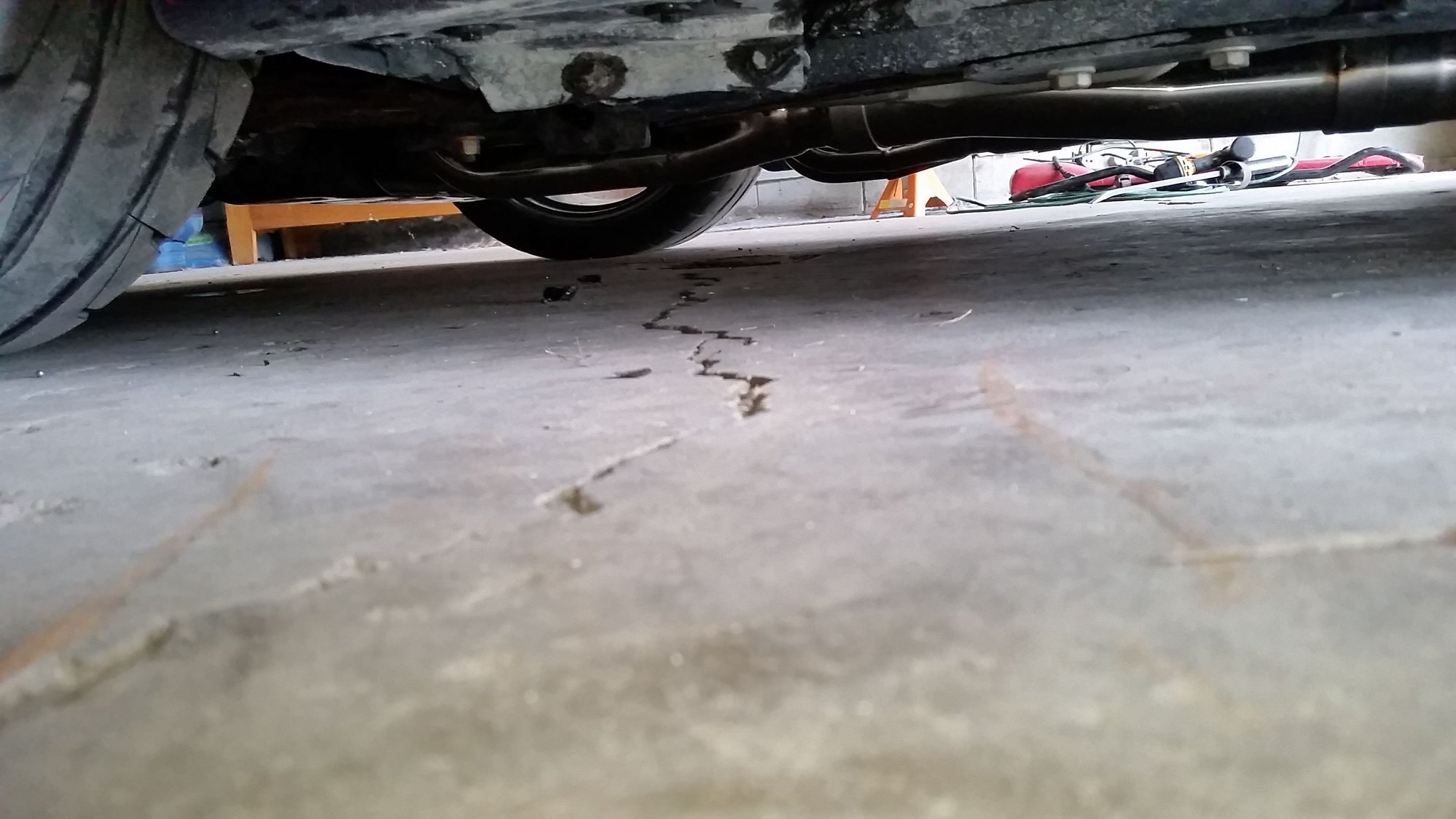

Just figured I would give a quick review of the 1 7/8" SE longtubes. All I can say, is compared to my old 1 3/4 slp's, these things are top notch for the price. Hands down I can't imagine better quality for the price. The fitment was real tight and I have plenty of clearance with a lowered car. I would highly recommend poly motor mounts due to how close it fits to the bottom of the car. If anyone is having a hard time deciding whether to buy these you will not be disappointed, just do it. Plus they have velocity spikes now!
Driver side and passenger side both slid up real nice, didn't take out my oil filter and passenger side I had my starter removed from doing the motor mounts so that went in real well. About 15 total hours by myself to install the LT'S, poly motor mounts, and remove a.i.r.
Only negative thing it can even think was a couple of exhaust clamps weren't as tight as would like but I can live with that. Something cool also is there is an extra bung if you want a wideband 02 set up.
Here are some pictures is took to give an idea of clearance, I know it's not the best quality but hopefully it will give you an idea.
Thanks Speed engineering! Very impressed!
Clearance around motor mount was perfect
Clearance around k-member. More than enough
This shows how tight it runs along the body. Clears, but highly recommend poly mounts or it will hit for sure. Less than 1/2"

Wow those tucked up better than I would've thought! Very nice

No problem sean! Thanks for such a great product and price! They do tuck up extremely close! Works out great being lowered and I got on it pretty hard today and no slapping with the poly mounts.

That ground clearance is impressive. If I stay NA, or decide against going turbo, I'm going to get a set of the 1 7/8" headers.
