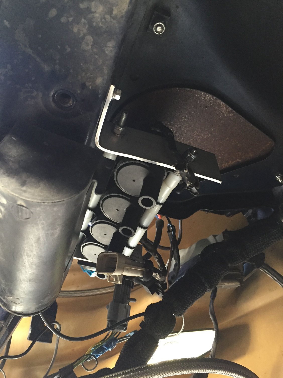

I am still in the process of my relocation. I am putting mine on the frame rails as well. I already have them mounted down there. But I will say to anyone relocating to the frame rail underneath and are NOT extending your factory harness. There is no way a 1' or 2' extension harness will be long enough. I bought a 3' harness and it's going to be very tight on the passenger side. Drivers side fits good. Not perfect but it will work. The passenger side however is going to be a doozy to make work. I would highly recommend a 4' extension harness that way you have plenty of slack to run the harness and tuck it nicely. Of course every install is a little different and a 3' may work for you but I would not even waste my time with a 1' or 2'. First 2 pics are of passenger side and 3 is of drivers side.
