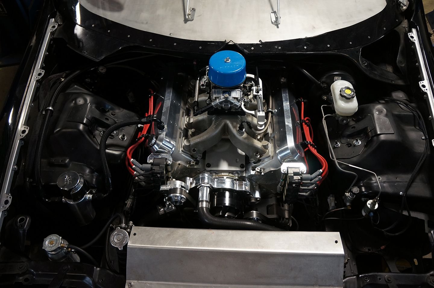

Old May 16, 2016 | 06:48 PM
John at CBM's Avatar
FormerVendor
Joined: Dec 2013
Posts: 323
Likes: 7
From: Ontario CA
Default My coil re location.
Here you go, Note: no power steering pump.
