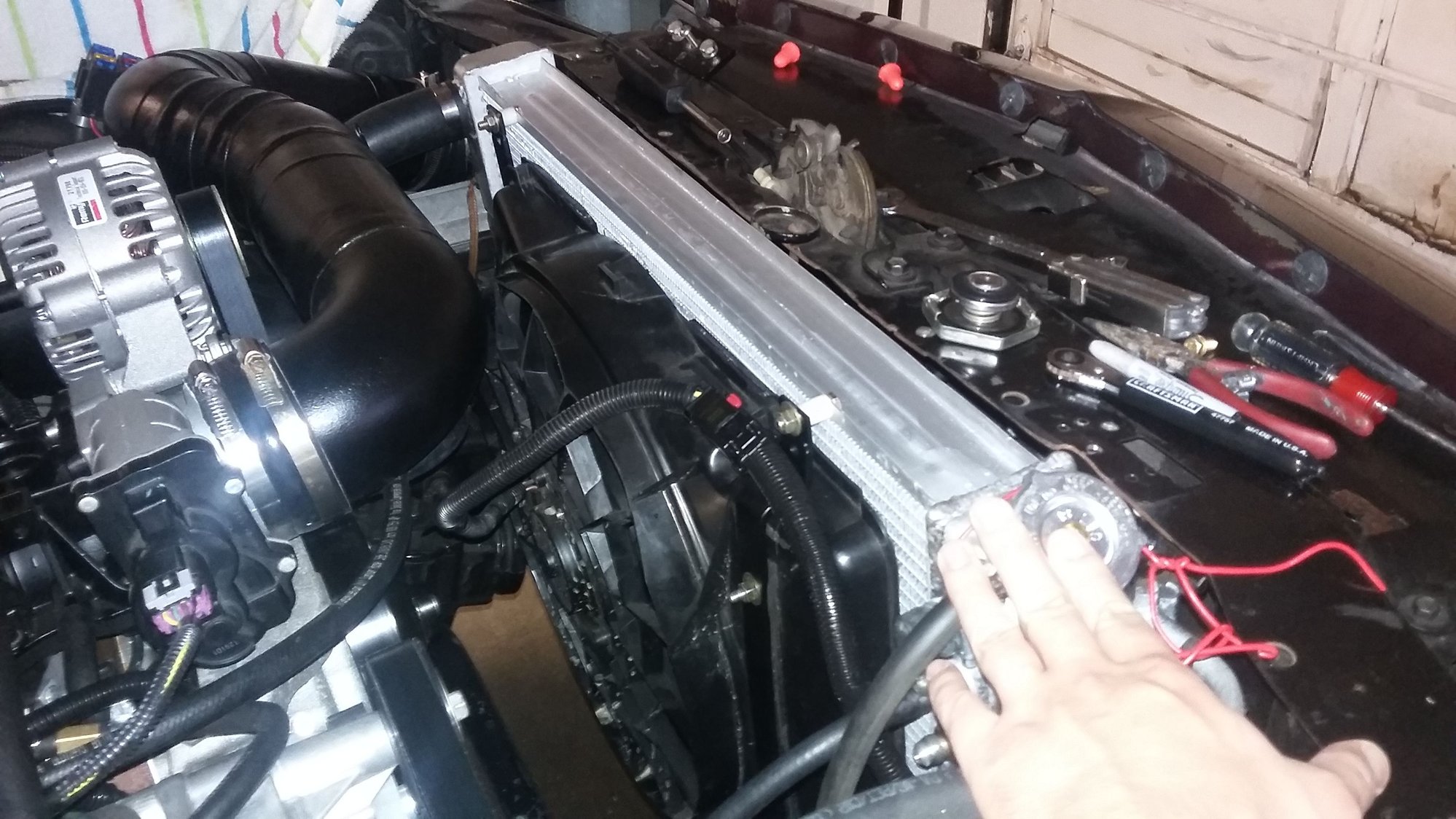

How much area of the radiator does the fans
cover? Is it possible they do not pull enough
air through radiator? Does the fans pull air through radiator or just all around? Does the radiator have baffles to guide air through radiator or can air go around radiator?
Just thoughts
Just thoughts
Here is a picture of my fan setup, it's a stock Taurus fan mounted on a universal radiator. My entire cooling system worked really good for a few years untill I started having this problem.

Are you loosing voltage to the fans?
How strong is the air being pulled through
radiator?
radiator?
The fans seem to be working pretty hard. I can drop some Teflon tape in front of my AC condenser, and the tape will get pulled against my AC compressor with some force
