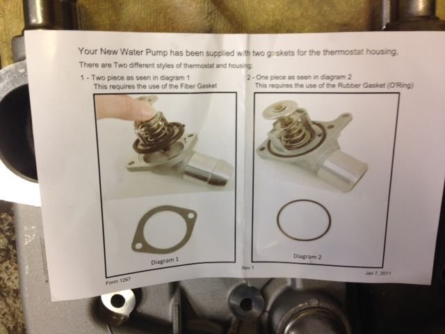

Received my new WP. This one, ACDELCO 252846, have provision for both kind of Thermostat housing.
