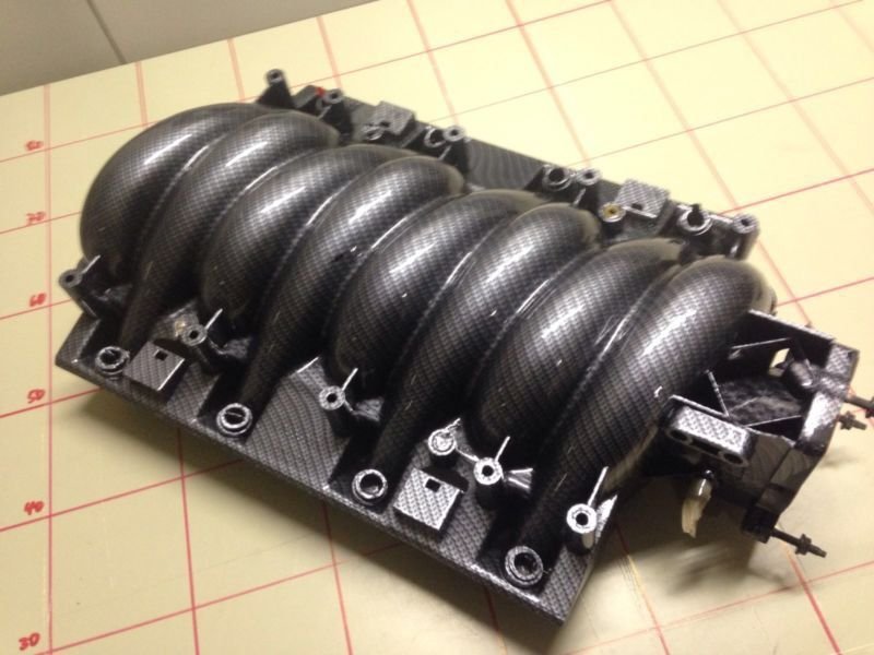

Is this LS1 or LS6 intake?
Old Aug 21, 2016 | 12:08 PM
Najania's Avatar
Joined: Sep 2008
Posts: 158
From: Denmark
Default Is this LS1 or LS6 intake?
Can you tell from a picture?
I've read the egr hole is missing means it's a LS6

Do you have a pic of the bottom ?
Usually no EGR hole is a LS6 intake but there are some LS1 intakes for the Corvette that don't have the hole either.

^^^yup. Also get the part number off the intake.

If the bottom is flat it's a LS6. If it's curved it's a LS1

I'm assuming its aftermarket so odds are in favor of it being an ls6 style as opposed to an ls1 style.

What's the part number?

That's an LS6 intake.

You can always look at the bottom and tell for sure, sometimes no hole may still be a ls1 from a vette.

I can't tell from that pic alone.
And how would you know that without seeing the bottom, or a part#?
You are correct...that could be an LS1 intake from an early Corvette...my bad.
